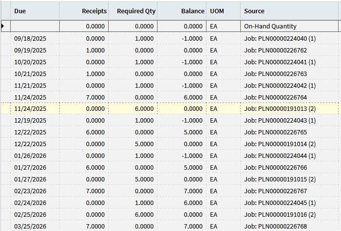

Here is a screen shot of part C time phase with Auto-Consume TRUE.

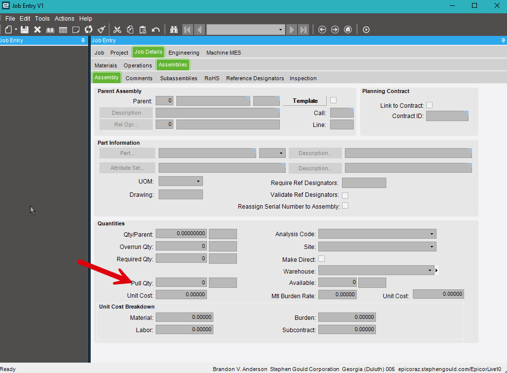

Hey @jlim . Welcome to the forum!
Unfortunately, Epicor doesn’t have any sort of function for “if this exists, then use it, otherwise use this”. Epicor creates a copy of the BOM when the job is created and it’s now a standalone copy of the BOM. So if you change the master, any firm jobs out there already will not be updated automatically.
Because it’s set up that way, the system won’t really know what’s in stock at the time of consumption, so it won’t know which way to go. You can issue assemblies to jobs if you happen to have them in stock, but it’s in no way automatic, and your planning isn’t going to adjust for that until you actually issue them to the job, or at least you add the pull qty to the assembly in the job.
You can set the “Pull Qty” to something other than 0 on an assembly and then the system will plan for that, buy someone has to do that manually. They would have to know about (or check for) any inventory in stock, then go to the jobs and set the pull qty on those specific jobs. Then the assemblies will have to be issued to the job, because there is not backflush for that part of the system.
The best that I’ve come with in the past is creating some dashboards that looks at job assemblies, and inventory, and if it finds inventory on hand shows up on the list for someone to do something about it. It’s not a great solution, and requires manual diligence to actually get it to work correctly.

Hate to have to go against @Banderson , but I believe he is incorrect.
You would need to set up B and C as Quantity Bearing = true, Non-Stock = true, Auto-Consume = true, and Plan As Assembly.
If I am remembering correctly, Auto-Consume only works with Plan As. Try that out and let us know.
I would love to be wrong!
Would this adjust the job so that the sub assembly would be on the job if there isn’t any? Or does it create jobs to make the stuff separately?
Creates jobs to make them separately. But having the subassembly as Plan As and Non-Stock means that the system will create a Job to Job demand link. I would also turn on Multi-Job so they all consider each other when scheduling.
