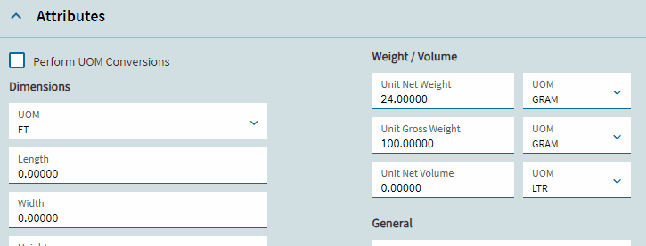

Not saying this is pretty, but its working:
unit conversion
Added a checkbox that sets TransView.ConvertUOM

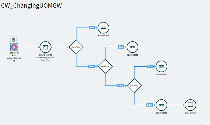

Then on Part.UOM changing (datatable column changed trigger), store the in a transview column in base units. The ugly condition cascade is checking for example “{Part. NetWeightUOM}” == “LB”, the row updates apply conversion factors TO base units in Transview.

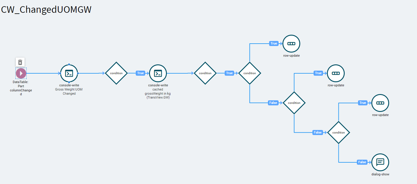

And on Part.UOM changed (datatable column changed trigger), convert the transview cached value back into Part.UOM units. The ugly condition cascade is checking for example “{Part. NetWeightUOM}” == “LB” same as in the previous OnChanging event. the row updates apply conversion factors FROM base units in Transview.
I had labeled the conditions with Shape Label, but it appears app studio loses these when you reload the layer.
This took best part of a day (!) to implement as Application Studio kept doing weird things, ended up scrapping layers a couple of times.
I also have a data rule to highlight the qty and UOM fields that are being converted when the convert checkbox is active, as you can see only GrossWeight and NetWeight currently dealt with.
