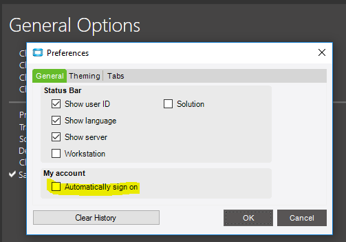

The way I do it is:
Setup the pass policy to allow save passwords.
Log in once as the user and set preferences to autologin

Epicor completely changed the way passwords are stored in the config files from 9 to 10, now they encrypt the password. Chris’ method is the approved method now.
On the Workstation where the HH client resides, remove the /HH from the command line of the shortcut and login using the standard Client Menu.
From that menu, go to Preferences and select the checkbox to store the user credentials.
Exit the client
Edit the Shortcut and add the /HH back to the command line.
Now the Hand Held client will use the stored credentials.
