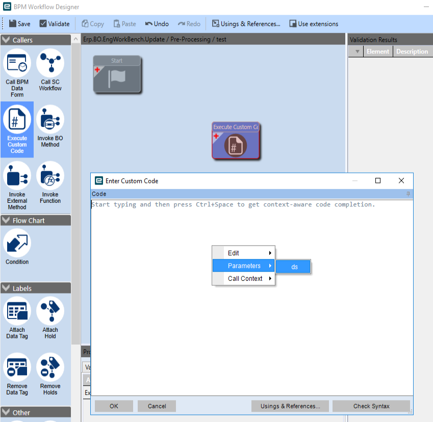

what :astonished: ?, do you mean when using Functions ?? if no, have you kindly got any example ?
i have just checked my revision 10.2.400.10 mate, no ttDate within this BO,
I am running 2021.2 in my screenshot and as you can see the tt tables are now gone
