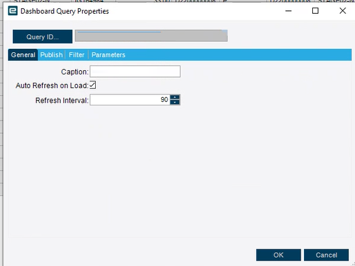

Is the “Auto Refresh by Interval” feature for dashboards no longer available in Kinetic? If so, are there any workarounds to refresh the dashboard page automatically at a specified interval, for example, every 2 minutes?
Let me know if there are any solutions or alternative workarounds.

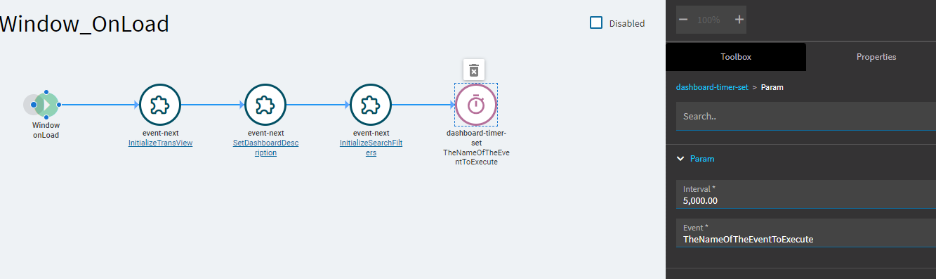

I haven’t used it before, but maybe try the dashboard-timer-set
event widget?

I just tested… dashboard-timer-set
should work for you.
Interval
is in ms, so 120000 would be 2 Minutes
Event
is the name of the event to execute on the interval
