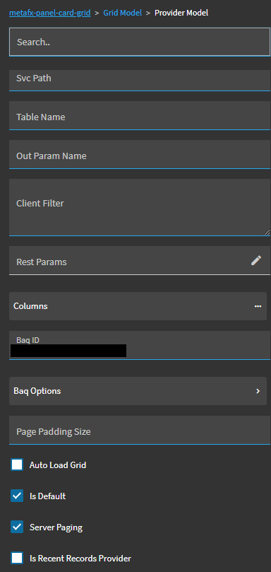

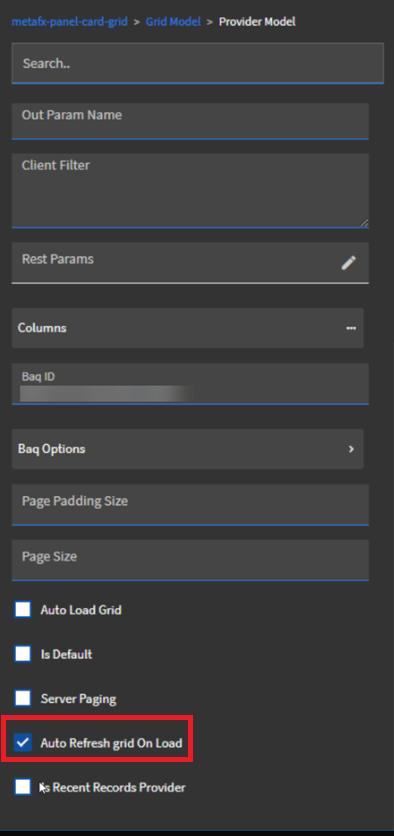

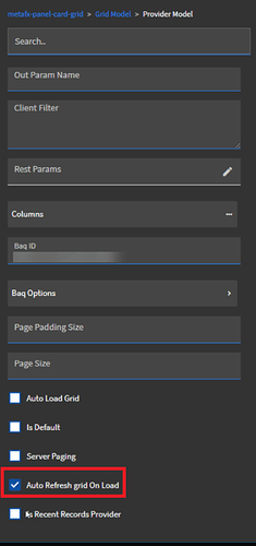

In a bit of Pub/Sub predicament where subscribed grids are not updating properly based on selection made in the publishing grid. I should note this a dashboard, It seems there is a consensus on making use of the “Auto Refresh Grid on Load” checkbox solving most problems. Just when I thought I was out of the pits come to find out… I don’t have the checkbox
That checkbox’s tool-tip says it is for loading data on INITIAL load. The tool-tip doesn’t seem to indicate it would have any bearing on refreshing it if the publishing grid’s row changes. But, we’ve seen crazier things.
What is your where clause in your BAQ options? Are your grids tied to dataviews at all?
I’ve opted to use the “Where List” that is given out the box for pub/subs on dashboard uplift. Originally, the “Where List” was utilizing the odd TransView condition that are created with the uplift. I toyed with rebinding these directly to the publishing DataView which helped, but it was not consistent. Each of the grids is bound to a DataView in the provider model that was given with the uplift.
