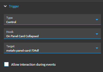

What if on your panel card behavior, added an event On Panel Card Collapse to then expand the card? That should tell Kinetic to open the card after collapsing it :crossed_fingers:
When I try that it doesn’t fire. I must be missing something.

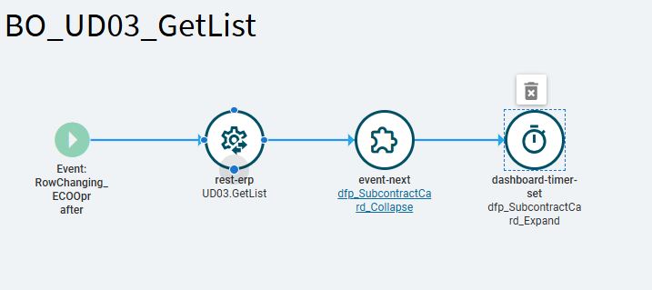

I got this to work by first creating two events for collapsing and expanding the card that have no trigger and a property-set widget, one where my card “expanded” property value is false (collapse) and one where it’s set to true (expand). Then in my event that I’m using to populate my data view, I added an event-next widget that calls the collapse event, followed by a dashboard-timer-set widget with an interval of 0.01 and set to then run my expand event.
This works pretty well (obviously you need to figure out what triggers the event that houses these widgets), with one HUGE caveat: the dashboard-timer-set event continuously fires every 0.01 ms. :man_facepalming:
I was able to get that to stop by adding a dashboard-timer-clear widget after it, but that kills the card re-expanding. It’s like the events fire off too fast for the expand event to happen before the timer is cleared. I’ve tried throwing a console-write widget after the collapse event, and myriad of other things to force some sort of pause after the collapse, but so far no success.

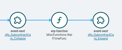

  1. Open Epicor Functions Maintenance (will use edge agent to open the classic form, you’ll have to have the client installed for this)
  2. Create a new library, I have one named MiscFunctions where I have one just like this.
  3. Give it a description and check the box for Custom Code Functions (right of the screen)
  4. Go to the Security tab and add your company to the Authorized list
  5. Save and then add Custom Code Function
  6. Give it a function ID and description
  7. Make it a little flexible if you want by creating a request parameter on the signature tab like WaitTime and make it an Int
  8. Hit the Edit button and add this code, replace WaitTime with your parameter name if it’s different or just hardcode an integer inside the () System.Threading.Thread.Sleep(this.WaitTime);
  9. Save and then go to Actions>Promote in the top menu
  10. Back in application studio add a kinetic-function widget
  11. Select your library and function
  12. Fill your WaitTime parameter (in milliseconds)
  13. You’re Done!
That works like a charm! Thank you very much for the detailed steps. :man_bowing:
