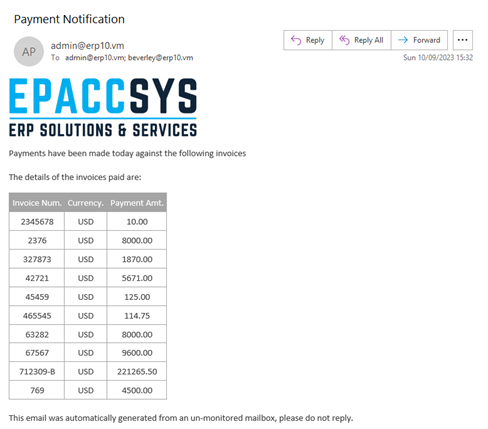

I have used functions to notify suppliers on payment of their invoices and customers of receipt of their payment - these can be scheduled to run overnight and give them a list of everything rather than individual emails for each item. Here is an example of an email to a supplier on posting a number of payments against multiple invoices:
All of the email elements (logo, fonts, colours etc.) are configured in User Codes so can be easily changed. The email goes to all Supplier Contacts with one or more pre-defined Role Codes

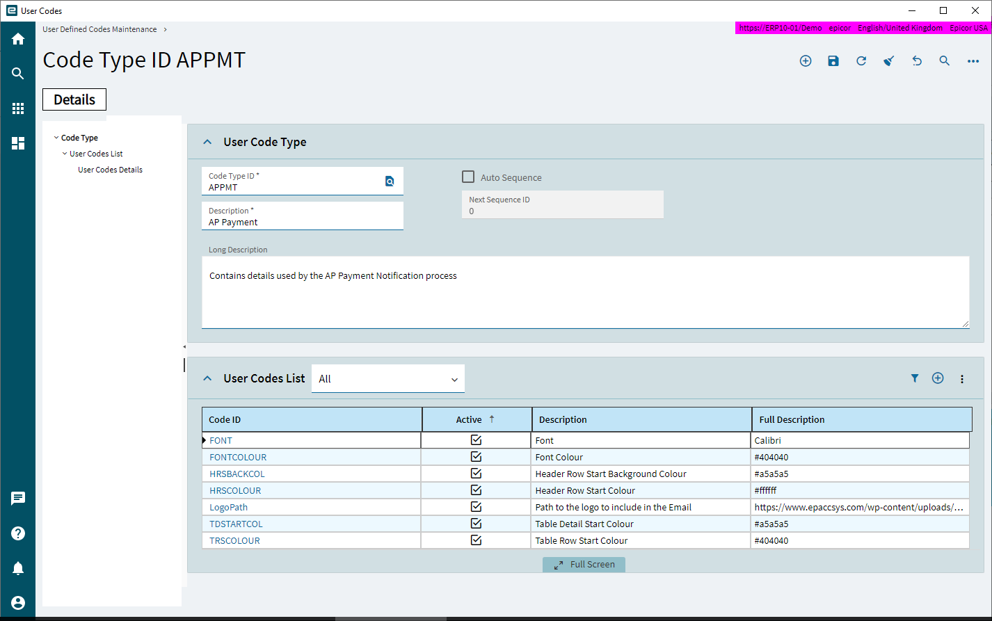

Create a User Code containing the elements that you want to use in your email:

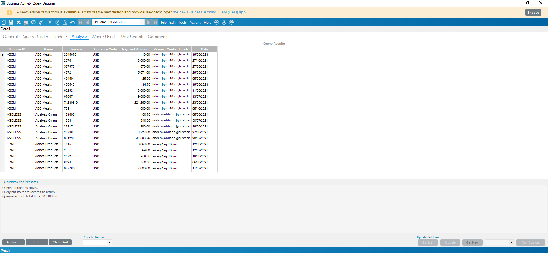

Then create a BAQ that returns the data that you need to include in the email:

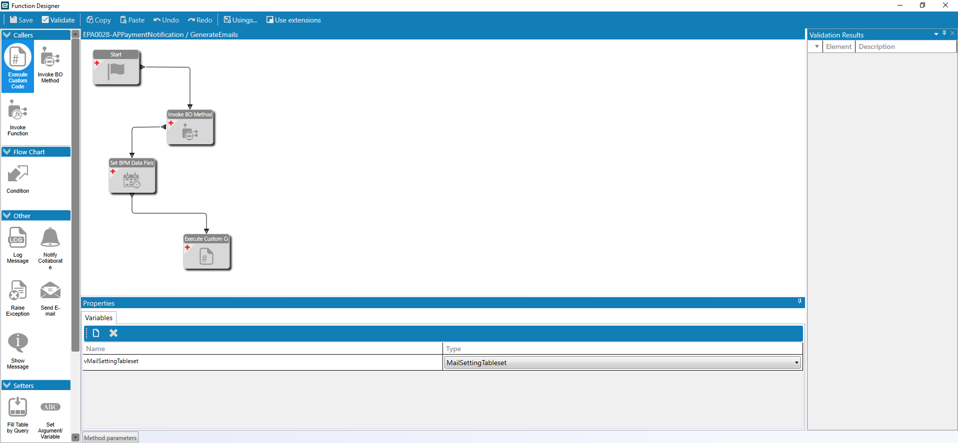

Then create a function, the BO Method call is to the MailSettings table so that I can get the “From email” address, then a custom code widget that first runs the BAQ and uses the results in the HTML email builder section of the code:
