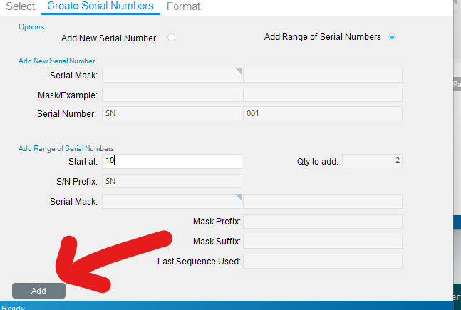

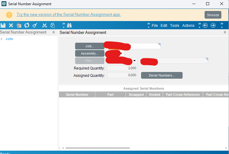

When we assign serial numbers manually inside Epicor, the system automatically creates new serial numbers based on the quantity.

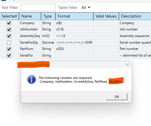

However, when we try to do the same using DMT, we must explicitly specify each serial number, which becomes a challenge.

  • We have to manually go into each assembly and assign serial numbers one by one.
  • This process is very time-consuming and error-prone.

  • DMT requires us to specify exact serial numbers.
  • To do that, we must first manually find:
    • The last serial number used for each part.
  • This again becomes a manual and time-consuming process, so DMT does not really help in this scenario.

Serial Number BOs are kind of a pain to work with as there are a lot of parameters and variables. But sure you can do this, I would do it with a function, that you can then call from a dashboard and supply the relevant inputs/monitor outputs.
You need to use Browser F12 Debug Tools on Kinetic to Trace what happens in the payload and response/preview for network calls when you perform the actions manually. This tells you how your web browser is “talking” to the Epicor Server.
Then, work back from that “conversation” to decipher the logic (get a blank record, add 5 to the quantity, send the updated record to the server with RowMod = “U”, etc.) to build into a function, calling the same business objects and performing the same actions.
