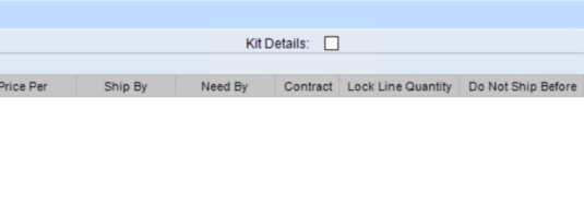

Hi everyone, I’m looking to change the default state of a native Kinetic control checkbox from false to true.
This is the ‘Kit Details’ checkbox (not a custom field) which controls the visibility of grid rows. Since it isn’t bound to a database field, I cannot use a BPM. I’m looking for the best way to handle this via Kinetic Customization to ensure it’s checked upon loading.

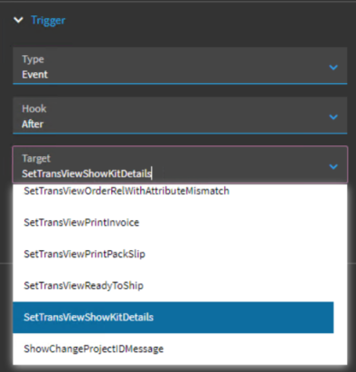

a quick event:

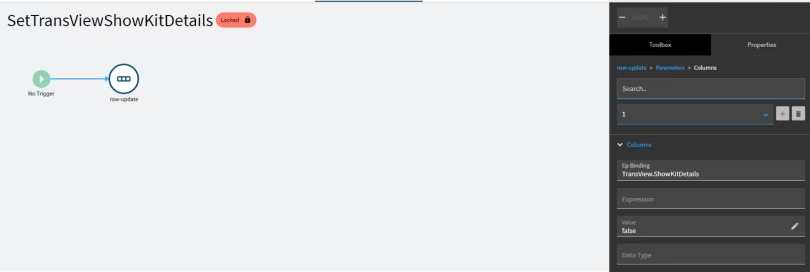

with a row-update of TransView.ShowKitDetails to a value of true
Works as a quick stab/starting point, but you’ll have to test whether you need to trigger this at different times.

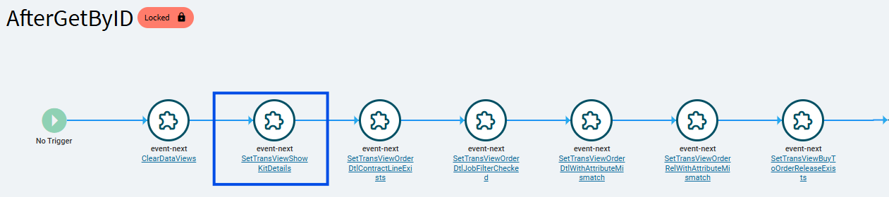

It seems I don’t have the OrderNum_onChange event, yet surprisingly I noticed the SetTransViewShowKitDetails event
CRAP… yeah… the OrderNum_onChange in my system is a custom event! :person_facepalming:
haha, sorry.
The SetTransviewShowKitDetails event is triggered in the AfterGetByID event:
Try triggering your event AFTER AfterGetByID.
I successfully set a checkbox to default-checked in Application Studio, but the change isn’t trickling down to the Classic UI. How can I force this implementation to apply in the Classic interface?
Kinetic UI and Classic UI are completely separate things.
You’ll have to recreate this customization on your Classic form.
