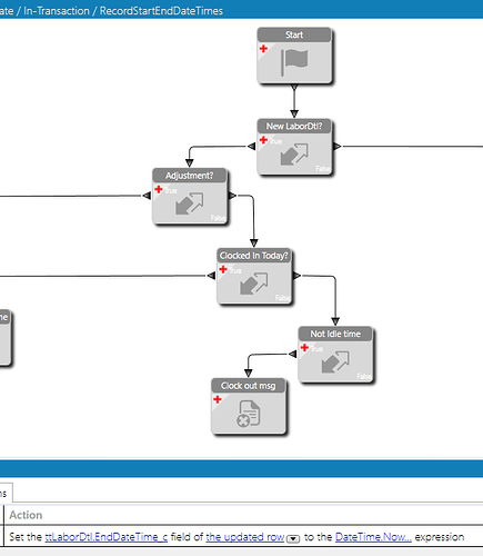

Lots of posts on this. Generally it is not advised, as it just propagates bad habits on the shop floor. We:

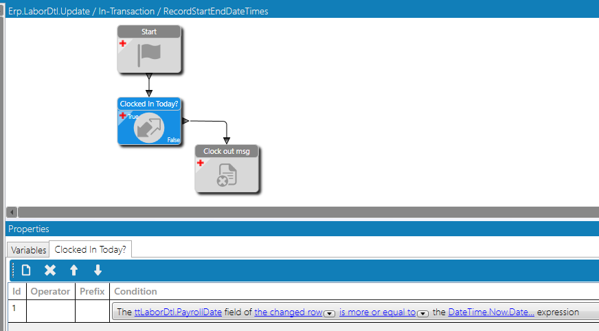

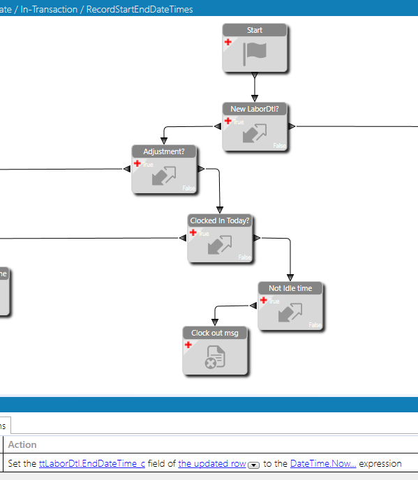

- Have BPMs not allowing people to start/stop activities if they forgot to clock out the day before. Says a warning message “Hey you forgot to clock out yesterday. Clock out and back in”.
- Have a dashboard that shows bad punches.
- Have a grid on each MES station screen showing punch status of that station’s employees.
- Supervisors are trained to fix bad punches in employee time entry.
- Accounting trained to run capture with a few days lag to allow editing bad punches.
1&2 are pretty easy. 3 is a little tricky. 4&5 were the most difficult…

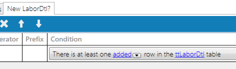

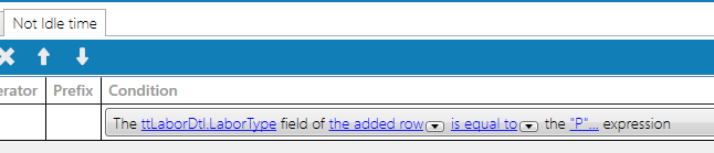

Apologies I simplified our BPM too much for you, you’ll want these extra conditions to not trigger on other labordtl events.
