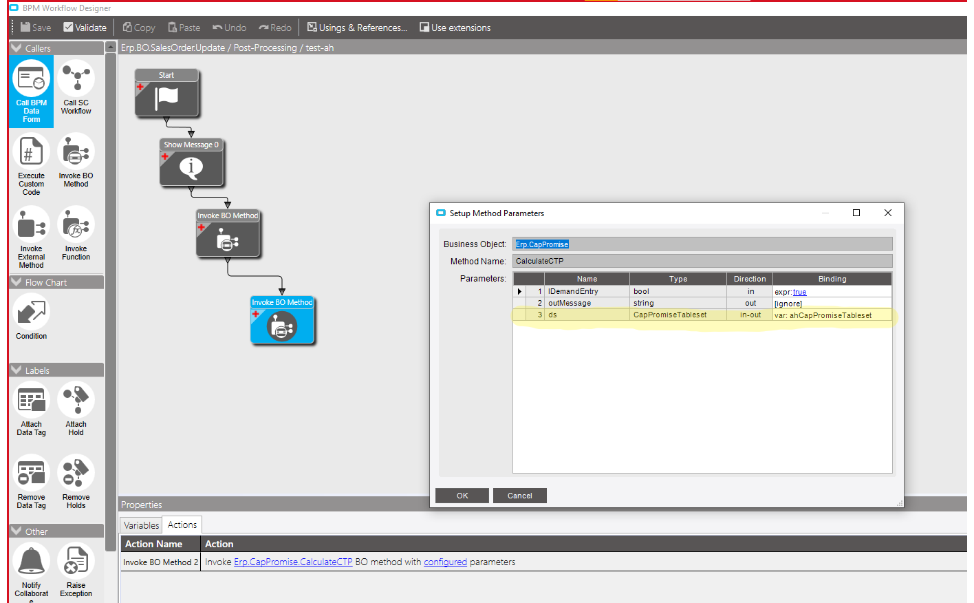

Has anyone tried to automate Capable to Promise in using a Method Directive?
I’d like to have CTP run automatically as EDI orders enter the system.
Within the Erp.BO.SalesOrder.Update method, I’m trying to trigger the method “CalculateCTP” and one of the specified parameters is requesting a type of “CapPromiseTableset”. I’m stuck on this parameter. How might I create a variable of this type?
Any ideas would be appreciated, thank you!

After running a trace, I see 3 CTP methods being used. I wrote this code using those methods and this video.
The BPM is triggered but I get an error regarding a null reference within the CalculateCTP method.
I think CapPromiseGetNew() is returning a CapPromise tableset that I’m putting in promData, but a null says otherwise.
Any tips on what I’m doing wrong, or how I could dig into my promData object? I’d like to view all its child parameters. Thanks!
