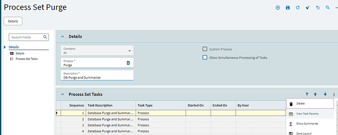

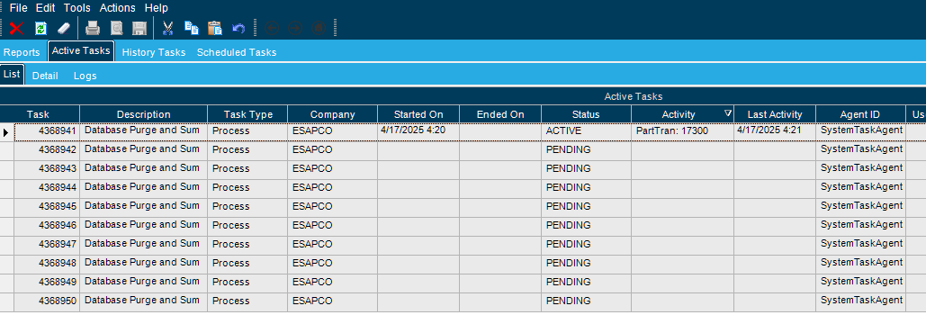

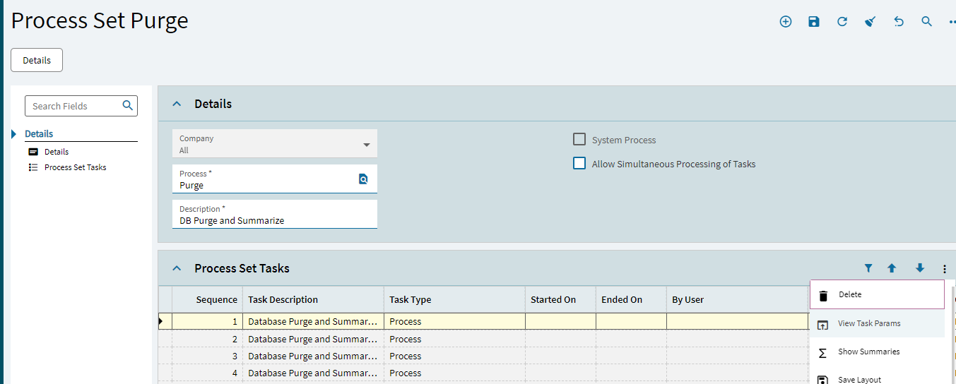

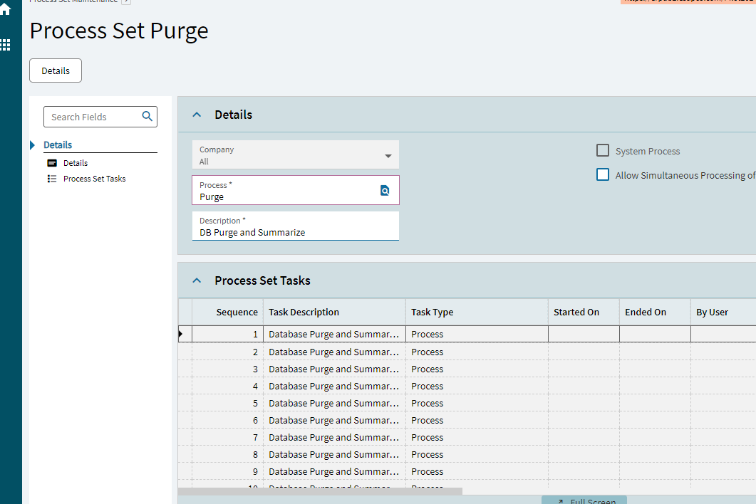

Update - I was able to set up a process set to purge the database! Epicor doesn’t play nice when you use the Kinetic db purge app and then open the classic process schedule app - it did not show the purge parameters properly.
Once I opened the process set in the Kinetic process set maintenance, parameters showed properly. I ran the process set, and it’s been running as intended.
To do this, create a process set (e.g. ‘Purge’), and then for each DB purge cut-off, schedule it in the Purge process set. I did mine annually for Job purge.
I’ll see if I can export a process set (from our dev environment), to use as a starting point for next year, so I don’t have to re-create this every year… I could do it in LIVE, but that scares me. Someone could accidentally run it, and our dev environments have everything purged to the 18mo cut-off, and LIVE we only purge part-trans and journal to a 3 year cut-off…
