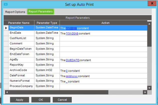

Another option I have helped a client with was setting up and using Customer Statements which allow you to define date ranges with Aging by Due Date, Invoice Date or Apply Date. The Statement was modified to look more like an Invoice and was setup for use with DocLink but it could also be setup with Auto Print/Email with a Data Directive, which does have the option for a filter on due date:
