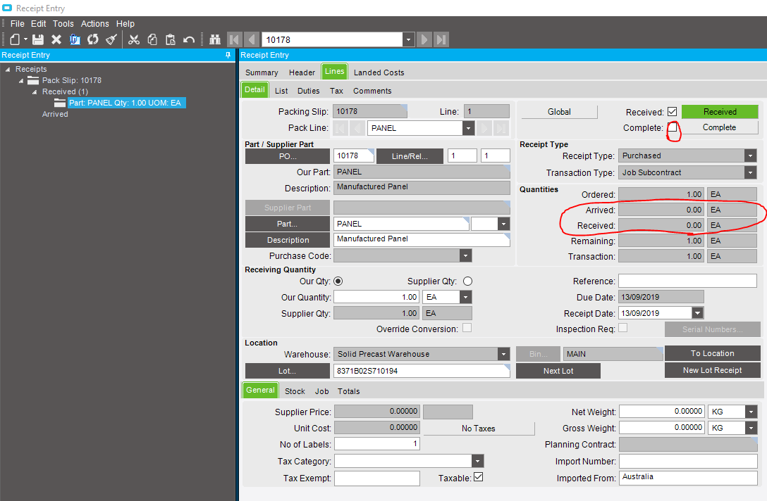

The code run successfully without errors, but then when I look at the Packslip in the Receipt Entry, the Complete tick box is not ticked, the Arrived Qty and Received Qty stays at zero.
If anyone has used BPM to receipt PO, can you shed some light?

Forgot to mentioned that the code was done in the Data directive Custom code.
I have followed the trace from DMT or UI, it looks like the code do work in Method Directive BPM, but it doesn’t work in Data Directive. If I do the code in Data Directive, it gets to this funny state.
