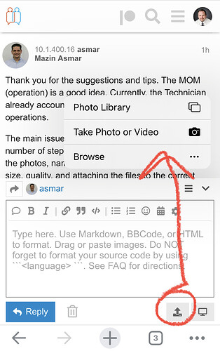

No. Keep it simple. If you are already using Epicor MES or Epicor Mobile Dashboard you might able to add take a photo for there ( or with a minor customisation).
Alternatively, you can also create a simple web page to upload the photo, easily. (if you know some database/html). Then add the photo/link of the photo to the job entry ERP by service connect/DMT/API

The technicians would scan the job number barcode on the job sheet and then click take a photo button using their tablet/phone. When they click on the upload button, "they’d get the devices camera " as Mr Calvin said. When they finished upload photo, they can click the next job button.
