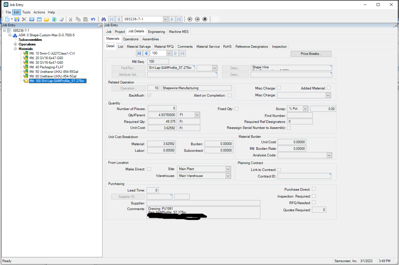

Some jobs aren’t being marked as Issue Complete as they are being back flushed with ever so slightly the wrong quantity. Nobody is changing the quantity on the job as far as I can tell, so I don’t know where to start looking. Ideas?

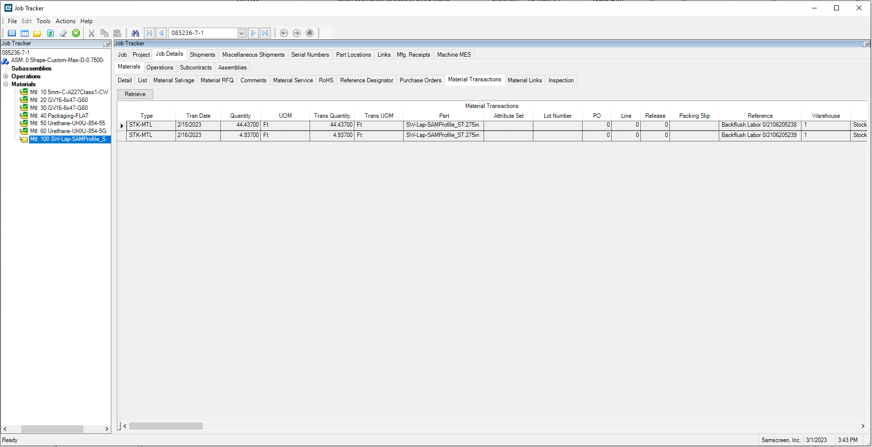

Hmm that would make sense if it was 493.375 vs 493.37. But its back flushing 493.374

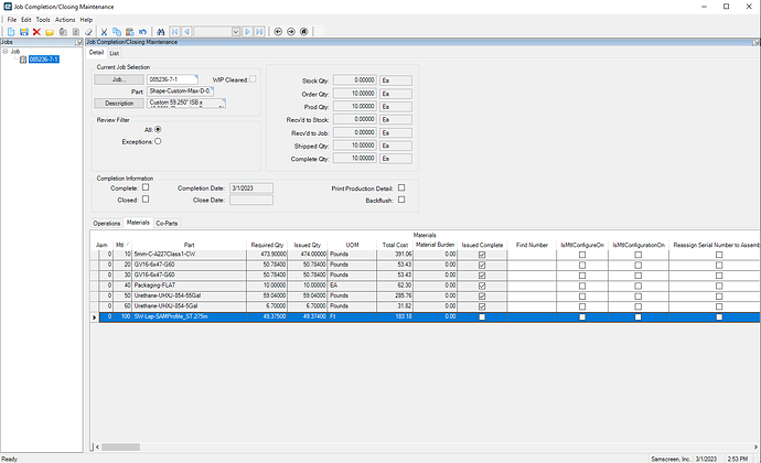

Well I just noticed another strange thing, the first material is also off by a little but that one still got marked as “Issue Complete”

So each part takes 4.93750000 of this material, if you round to two decimals that is 4.94. There are 10 parts, so that would be 49.4 ft of material, but what we see if 49.374 ft of material.
Its off by 0.0001 per part, or 0.001 over 10 parts… And that doesn’t explain why the issue complete is checked off for the first item but not the second one

If you notice, it is off by a little bit more than required while the other one is a little bit less.
