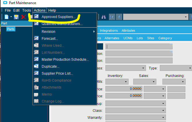

Approved supplier can be accessed from part maintenance
