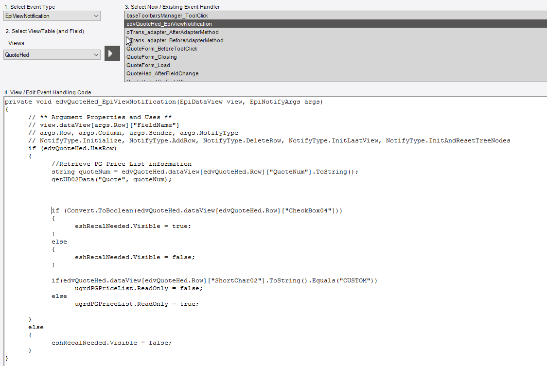

I can try dumping the code into the existing EpiViewNotification that we are already using which highlights whether or not the user needs to recalc or not. This is what it is currently doing:
