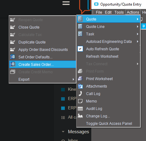

I have never used Epicor 9 if that really is the version you are on but in 10.2.600 and probably most 10. versions and newer you can go from the Quote and flip it to a sales order but using the Action > Quote > Create Sales Order
This is exactly what I was looking for. Thank you! I’m using Epicor 9, and has the same functionality. I appreciate the advice.
Keep in mind in Epicor it’s not a 1:1 relationship between quote and order. You can create multiple orders from one quote, as in you quote the customer and they order repeatedly.
