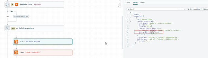

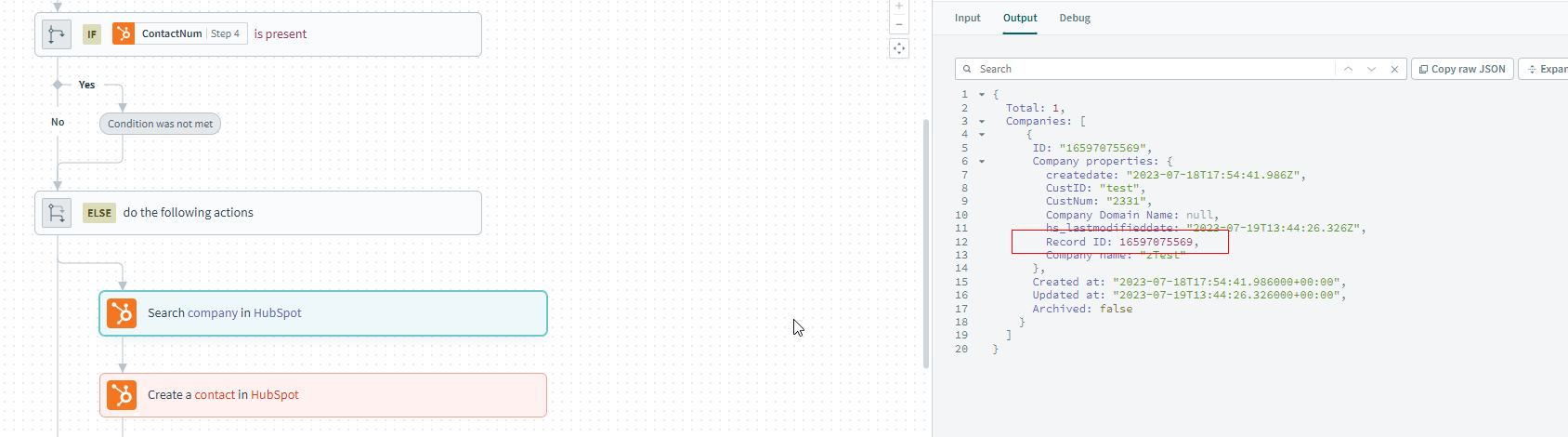

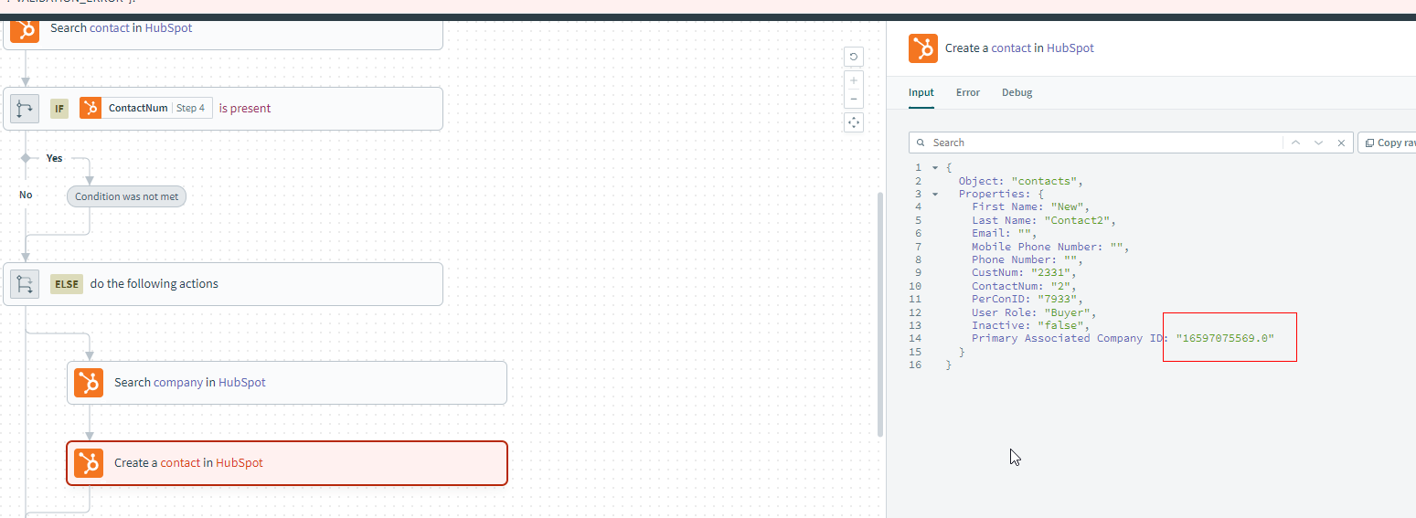

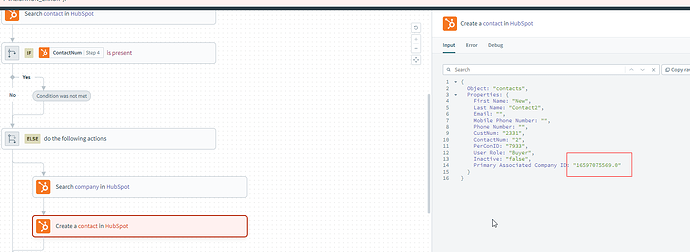

This may be kind of an obscure problem but . . . I am trying to set up an integration between Kinetic and Hubspot using the workato hubspot connector. In general it works great. But I am trying to create a contact in hubspot and one of the fields I need to populate is the company association. I am searching for the record ID of the company in Hubspot and then sending that in my put request. But somehow workato is treating the returned record ID of the company as a decimal instead of a string and appending “.0” to it which then of course doesn’t match anything.
I’ve tried using to int and to string on my data pill but neither works - to string does not get rid of the .0, and to int just ends up null.

Nope when I send in the ID then I just see null in the put.
When you send the data back use the formula option and chage the format of the field you can try using
{field}.round(0)
THANK YOU!!! I don’t know why I didn’t see that.
