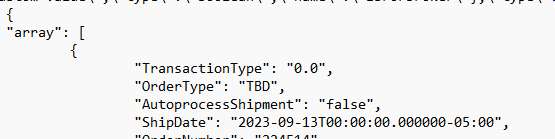

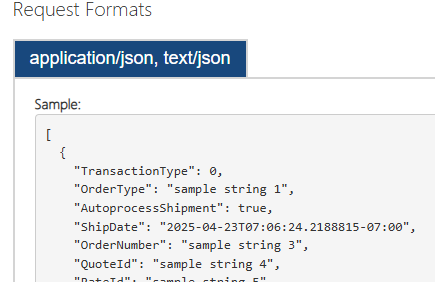

I’m using the http connector to call an API that doesn’t have a dedicated connector in Workato. The API requires the request body to be an unnamed array
The Workato http connector won’t let me do an unnamed array, so I end up with a body that the API can’t process

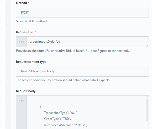

There is an option to set the http connector request type to Raw JSON request body.
I’ve tested pasting a properly structured request into the request body and it worked as expected.
If I could get Workato to create the request body and then put it into a string variable, I could use a formula to remove the array name from the string. Then I could send the string the request body. I haven’t figured out a way to make that happen yet.
