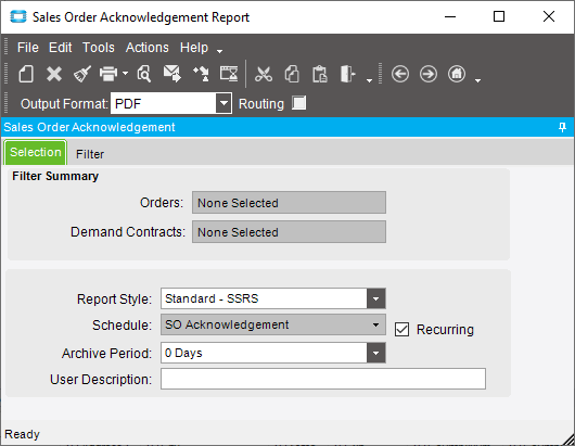

I imported the UIRpts.SalesAck.dll through menu maintenance and added this. I tried using it and it works if you want to send one massive pdf of all the reports. But there is no feature where I could send a separate email per customer with their respective report.
Do you have the Advanced Print Routing module? APR will allow you to break the report up into smaller pieces and email those.

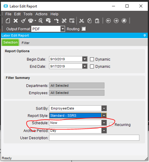

The reports tell people they have tasks to complete in ECOs. Currently, whenever a new employee is added to the process, I set the report to recurring, choose the morning schedule, filter on the employee’s salesrep codes, and fill out the email info. Then I repeat for the afternoon schedule. I can’t modify the parameters from System Agent, so I need to delete and recreate to change anything. The reports also run a second time if they don’t all finish generating in two minutes, so I actually have two morning and two afternoon schedules to split them up. I can’t find a way to put the reports on a process set, either.
