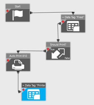

  • Finally, I have an AutoPrint Data Directive BPM that fires when InvcHead is changed. This is used to either a.) email an SSRS Invoice to a customer using Advanced Print Routing or b.) generate EDI invoice output to a text file:
Everything runs as expected (packing list is marked shipped, invoice is posted, etc.) and the AutoPrint BPM is definitely firing and reaching the end of its workflow (as you can see, I attach some “debug” Data Tags to the InvcHead record during BPM execution), but no output - either when exporting SSRS to APR or using EDI output.

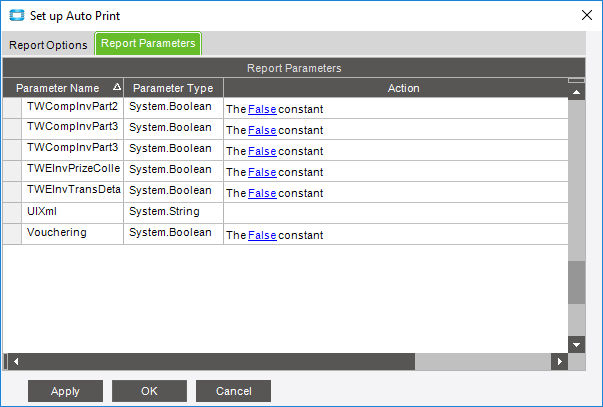

After debugging the BPM and trial and error on each null field in the ArInvFormParam tableset, I determined that WorkstationID is null when the BPM is triggered from WCF.
Unfortunately, WorkstationID cannot be set from the UI:
Any ideas how I can get that value set? I tried using a custom code block, but ArInvFormParam isn’t in scope yet and setting a value for Session.WorkstationID doesn’t seem to carry through to the params.
