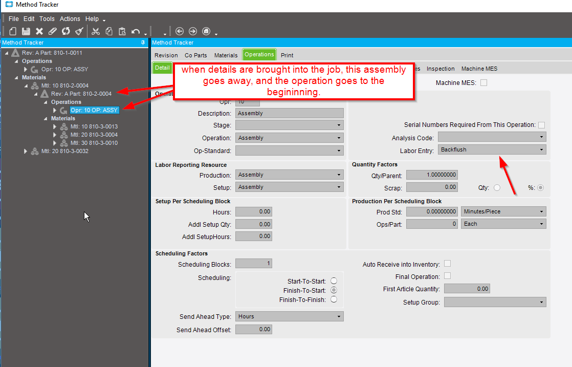

When we use phantom boms, we just add the operation as backflush. Then you set up your backflush processing and it will complete the operation automatically.
Set this up on a schedule (don’t use the settings shown, I just took a screen shot to show you the screen), we have ours run every 2 minutes, which is probably overkill.
Get the hell outta here, it’s that easy? Bahaha. Well, I guess as long as one is still learning, one is still useful. :stuck_out_tongue_winking_eye: Thanks @Banderson
What else does that Process Labor do? It only affects backflush labor items right?
I don’t know why you haven’t just made your own ERP system from scratch yet, you’d probably do less work. Haha.
Yes, as far as I know. We haven’t seen it mess with anything else here. Been running it like that for over a year now.
