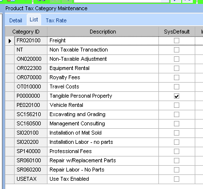

Here’s our Product Tax Categories:
Note that the CategoryID is assigned by Avalara (or at a minimum must match the avalara dashboard), and that the Tax rate for each of those is blank.

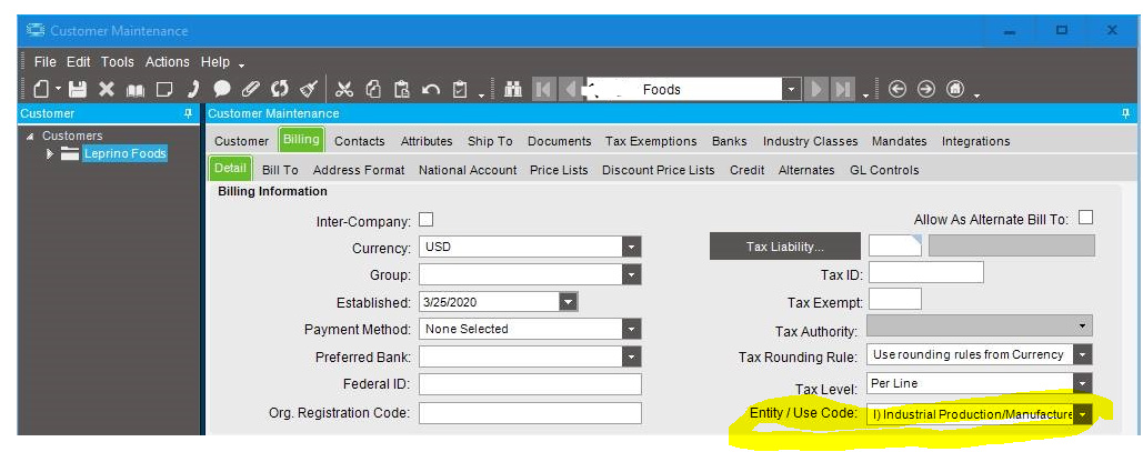

Did you set the Entity Use Code to “I” on the Customer in Customer Maintenance?

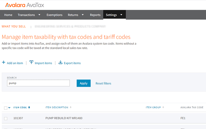

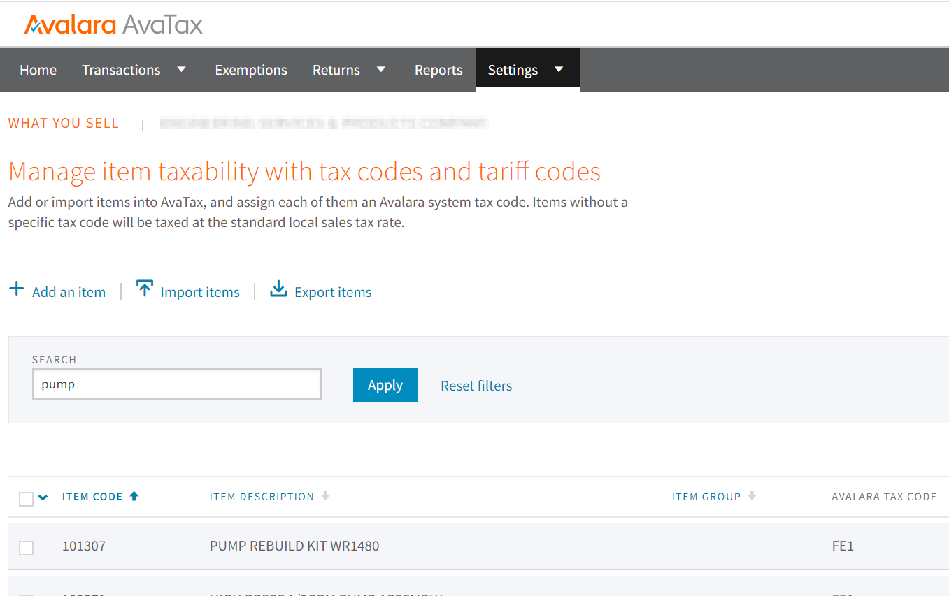

Maybe something similar could be used with a custom tax rate for an Avalara Item Code for machinery… You would enter the PartNum in Avatax under Settings > What You Sell, and then set the appropriate Avalara or custom tax code.
Yep, I sure did, and I did likewise on the ship-to record and the sales order release record. Come to find out that all of the changes I made in both Epicor and CertCapture apparently were correct after all, because the CA state tax component for the order is now being calculating correctly at 2.0625% instead of 6.0000%. The synchronization of the updated certificate information in CertCapture with the corresponding AvaTax record apparently took a VERY long time.
