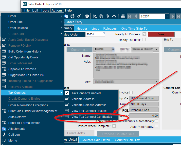

If you were running Kinetic 2022.2 or later, Automation Studio would not be required. Tax Connect has been enhanced to work much more elegantly with Avalara AvaTax and its ECM capabilities. See “CertCapture Settings” in Company Configuration > Tax Interface card, “Send Customer to Tax Connect” and “Request Certificate Invite” actions in Customer Entry, and “View Tax Connect Certificates” action in Sales Order Entry.

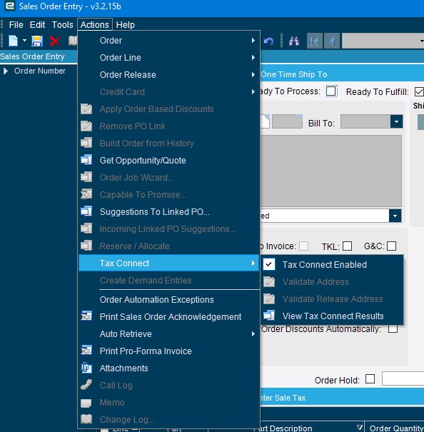

We’re on 2022.2.8, but I don’t see those settings in Company Config, Customer Entry, or Sales Order Entry. I tried for find mention of it in the help files, but didn’t. Any ideas? Our A/R dept would love to streamline as much as possible within Epicor instead of needing to go out to the Avalara portal to manage customer tax certificates.
Well now, that ain’t cool! I don’t know what to say, Andris. Perhaps I was given an incorrect release for the introduction of the new features. I can confirm that the features exist in 2023.1, but that doesn’t really help you.

There is a new ‘feature’ on the on the menu Action > Tax Connect > View Tax Connect Certificates. But, it always returns “Customer Not Found. The Customer with ID ‘AA123’ was not found.” Same message whether the customer has a CertCapture certificate or not.

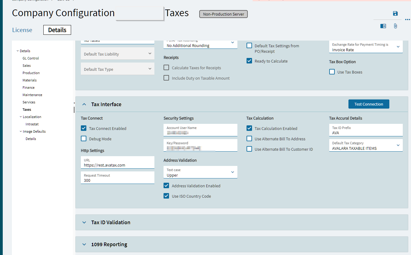

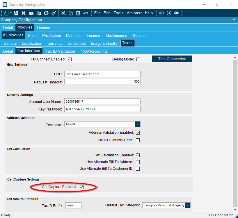

There is a new checkbox in Company Config > Taxes > Tax Interfaces named "CertCapture Enabled. I have that checked.

First, you have to check a checkbox in Company Configuration:
Then, this option is available in Order Entry and Quote and Invoice Entry:
That opens a pop-up grid of the certificates at Avalara ECM for that customer, with a Preview button that shows the ECM certificate:

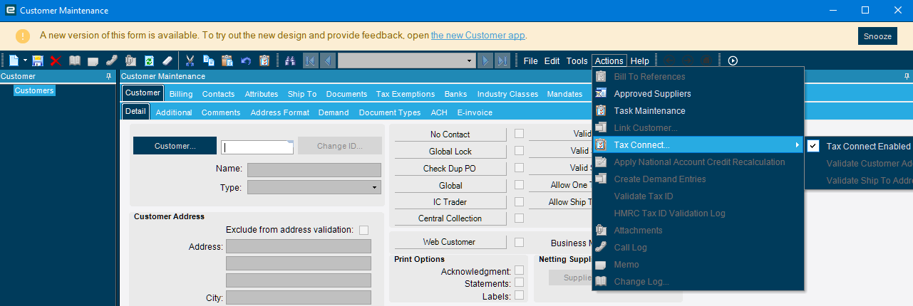

  1. The View Tax Connect Certificate submenu on Tax Connect action is not on Customer Maint, Customer Tracker or Invoice Tracker where it would do some good for us in our workflow.

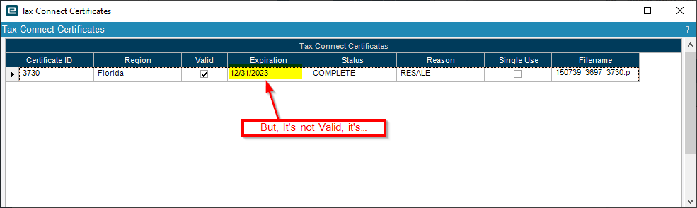

  3. If a Customer has a certificate that is expired, the View Certificate grid does not seem to notice, and happily shows the Valid checkbox as checked, even though Avatax would know the cert is expired and charge tax…

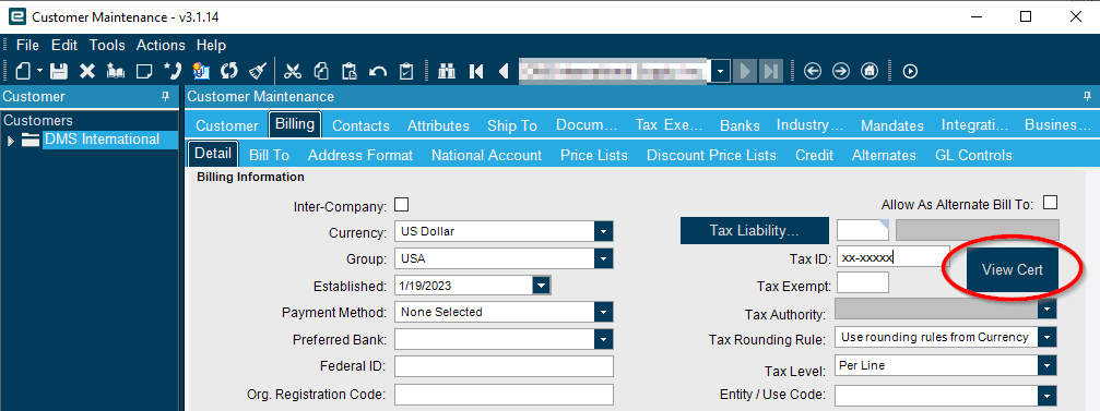

For bad news item 1, I added a button on the Customer screens that calls the Avalara process.
Here is the code for the button click event:
private void epiButtonViewCert_Click(object sender, System.EventArgs args)
		EpiDataView edv = (EpiDataView)(oTrans.EpiDataViews["Customer"]);
		Int32 custNum = (Int32)edv.dataView[0]["CustNum"];
		ProcessCaller.LaunchForm(oTrans, "PR000093", custNum.ToString() );
For bad news item 3, I’m going to customize that view with a Row Rule that will turn the Expired cell red if it is expired.
