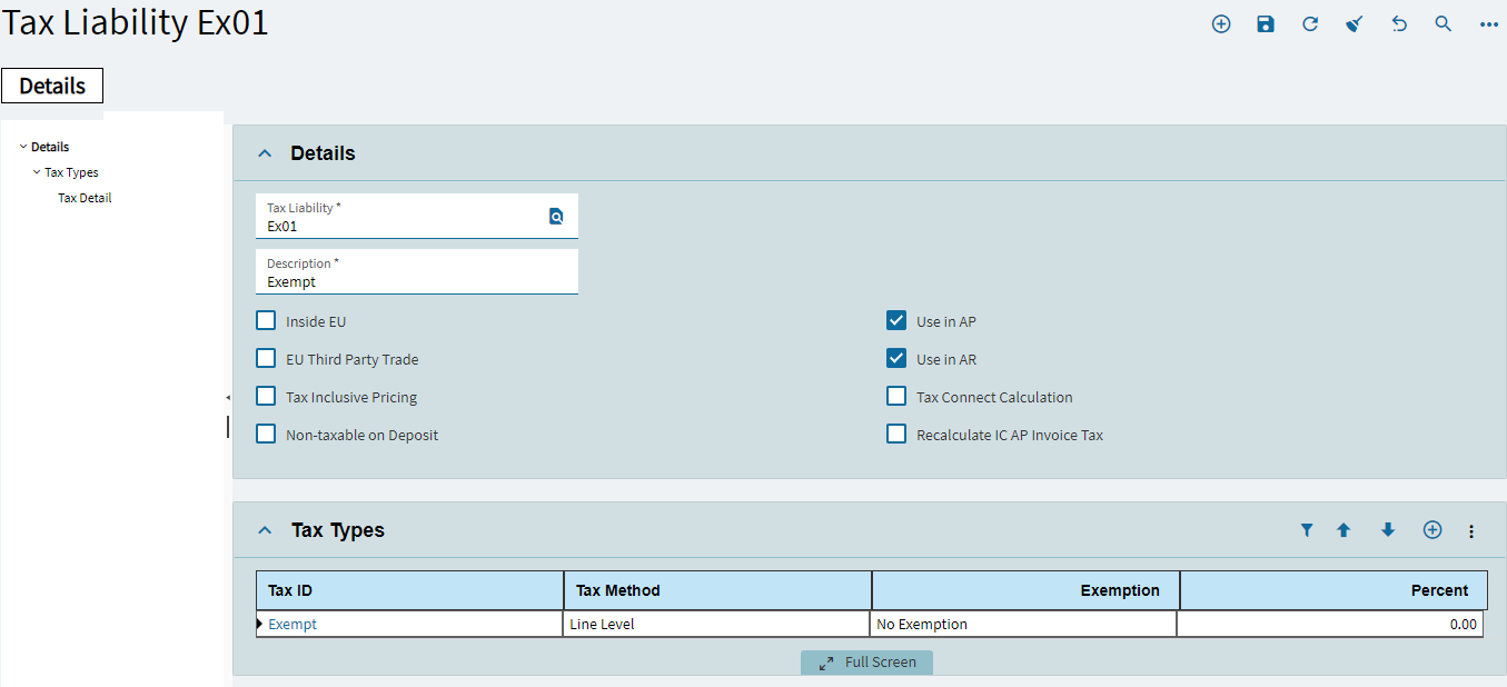

Can you screenshot the Tax Liability setup screen? There should be a checkbox that says use tax interface or something like that. If it is unchecked then you can stop it from hitting Avalara all together

We’ve got that unchecked. Nothing changed.

It looks like it’s the “Tax connect calculation” flag on that tax liability that @TomAlexander is talking about.

If that’s the case, what’s the purpose of the “Tax Connect Calculation” checkbox in Tax Liability Entry?

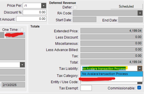

Andris, we set the tax liability on the invoice line like this… is that the same as a region code?

Utah - Correct. The tax region code is the tax liability. We’ve got our code as ‘NTS’ for one company (Non-Taxable State) and ‘Ex01’ (Exempt) for the other one. Neither have ‘Tax Connect Calculation’ checked in the Tax Liability Entry module.
