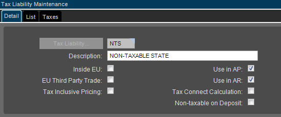

We’ve set up “non-taxable state” as as an entry in tax liability, so the non-sales tax state customers don’t even get an Avalara calculation (and fee).
Thank you very much Andris.
Just to verify, on the Tax Liability maintenance form, first tab, is the “Tax Connect Calculation” checked or unchecked?
Thanks,
John
John - It is unchecked.
Thanks Andris, we will give it a try.
