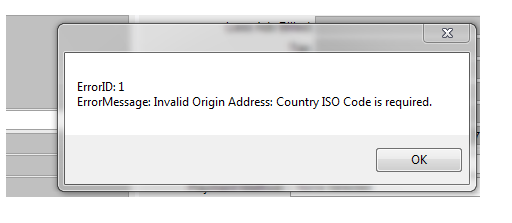

When we are doing a credit memo for an RMA, I cannot get the taxes to calculate on the credit memo invoice.
I have already checked the site, company , and warehouse addresses and they all have the country code filled in.
It keeps saying this:

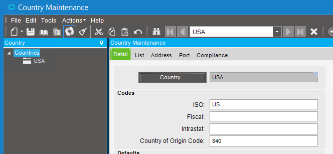

Likely this:
Thanks Jason, that is set up correctly.
