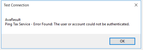

@Jonathan Our testing is setup with this URL and we are still getting an error. I have opened a support ticket with Avalara.
As long as the error is about authentication it means the call is reaching Avalara correctly but failing due to the credentials, otherwise the error would be different.
So does that mean the test worked? And yes, the error is about authentication.
Yes, it is using TLS 1.2 if it is able to connect and check the credentials. You get below error

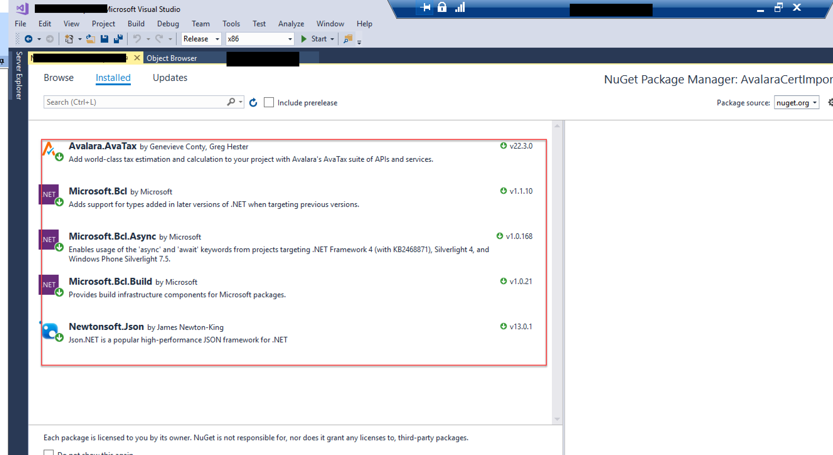

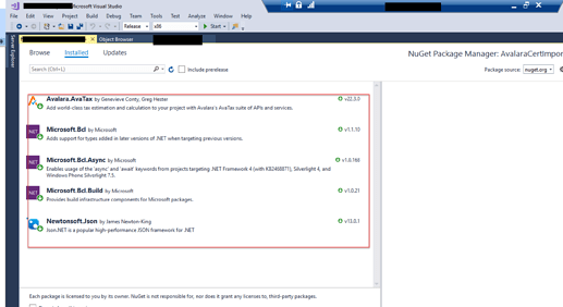

I’m trying to help a customer with a custom .NET app they wrote which uses an AvaTax RestClient NuGet Gallery | Avalara.AvaTax 22.3.0
Getting errors like this at runtime:
Unhandled Exception: System.Net.Http.HttpRequestException: An error occurred while sending the request. —> System.Net.WebException: The underlying connection was closed: An unexpected error occurred on a send. —> System.IO.IOException: Authentication failed because the remote party has closed the transport stream.
Pretty sure it’s a TLS issue given the error syntax and timing, but not sure how to solve yet…
I tried going into Visual Studio and updating these packages:
But that did not help.
Going to try working with someone at Avalara, but hoping someone here might have advice in the meantime… @Jonathan @Mark_Wonsil @Olga @josecgomez

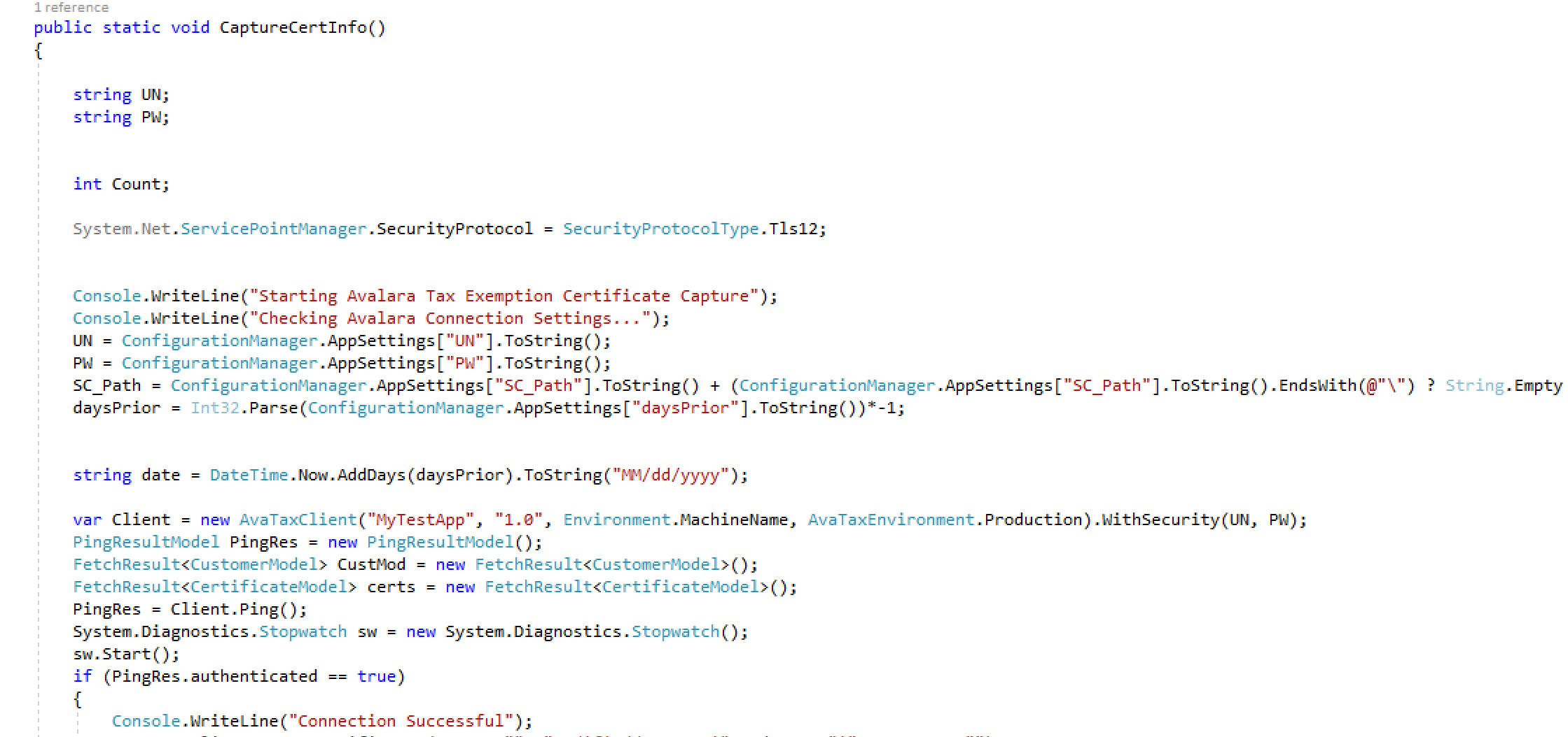

Edit: It appears this may do the trick:
        System.Net.ServicePointManager.SecurityProtocol = SecurityProtocolType.Tls12;
Can you post the part of the code that sets up the initial connection? Is it using Josh and Jose’s Nuget package (doesn’t appear in your list of libraries though…doesn’t appear to use RestSharp either… :thinking: )
Seems very straightforward… I’m wondering if the root issue is some weird registry or certificate thing on the machine it’s running on. But that ServicePointManager.SecurityProtocol bit seems to make it work now.
