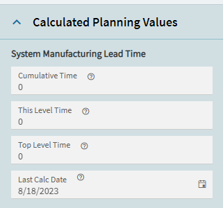

We have a simple sheet metal manufactured part with 10 pounds of steel as a material, has a lead time of 7 days.
The calculation returns zero for cumulative time under Calculating Planning Values for the manufactured part.
Am I missing something? Is this Lead Time Calculation even used by real users?

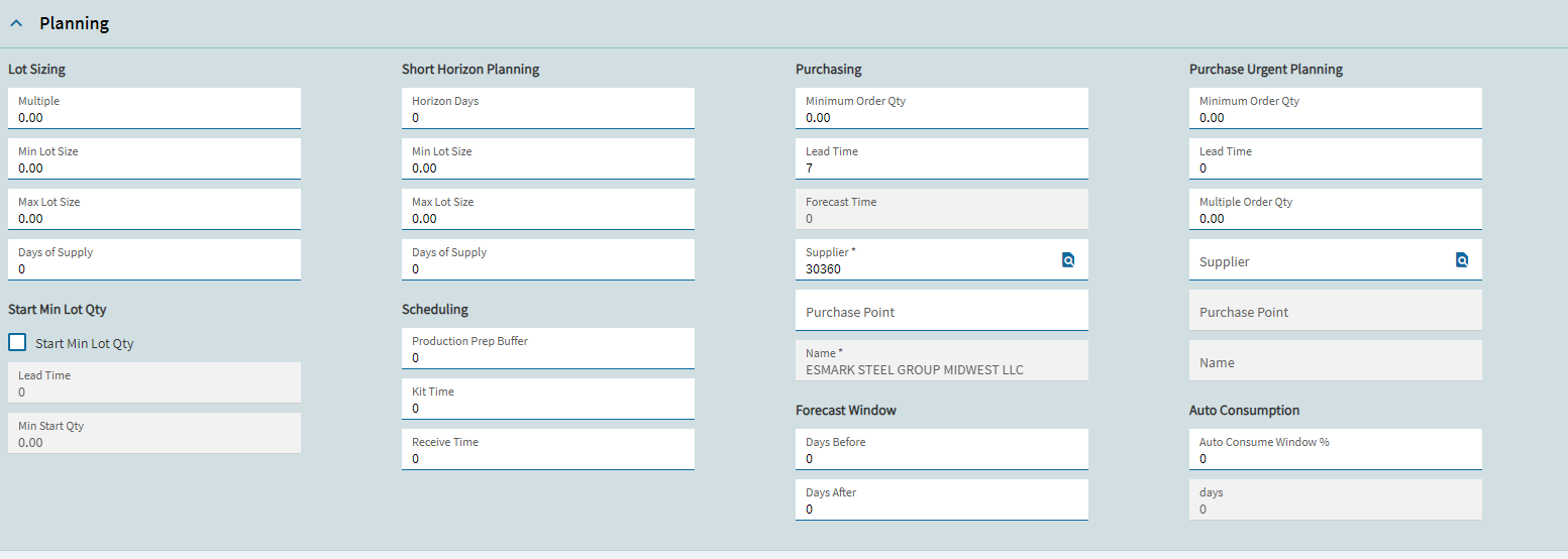

Do you have a Supplier Price List entry for that part? Where is the 7 day lead time entered?
kpete
(Kent Petersen)
August 21, 2023, 3:43pm
3

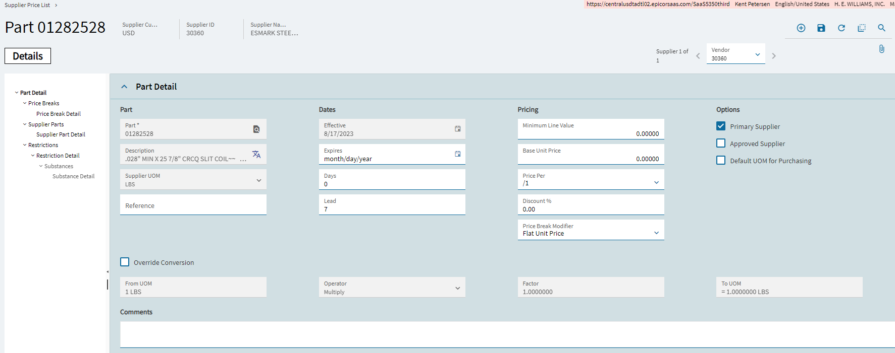

on the planning section of the PART screen.
I also put it on a price list for the supplier because I don’t know which one takes precedence.
kpete
(Kent Petersen)
August 21, 2023, 3:45pm
4

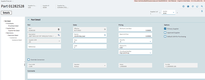

There is the supplier price list entry.

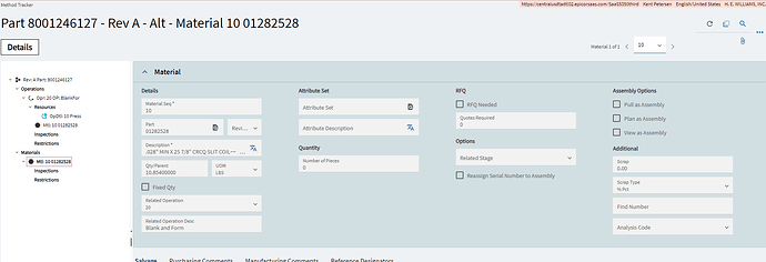

Manufactured Part: 8001246127
It has a method which contains purchased part: 01282528.

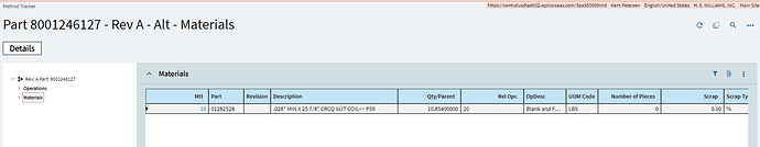

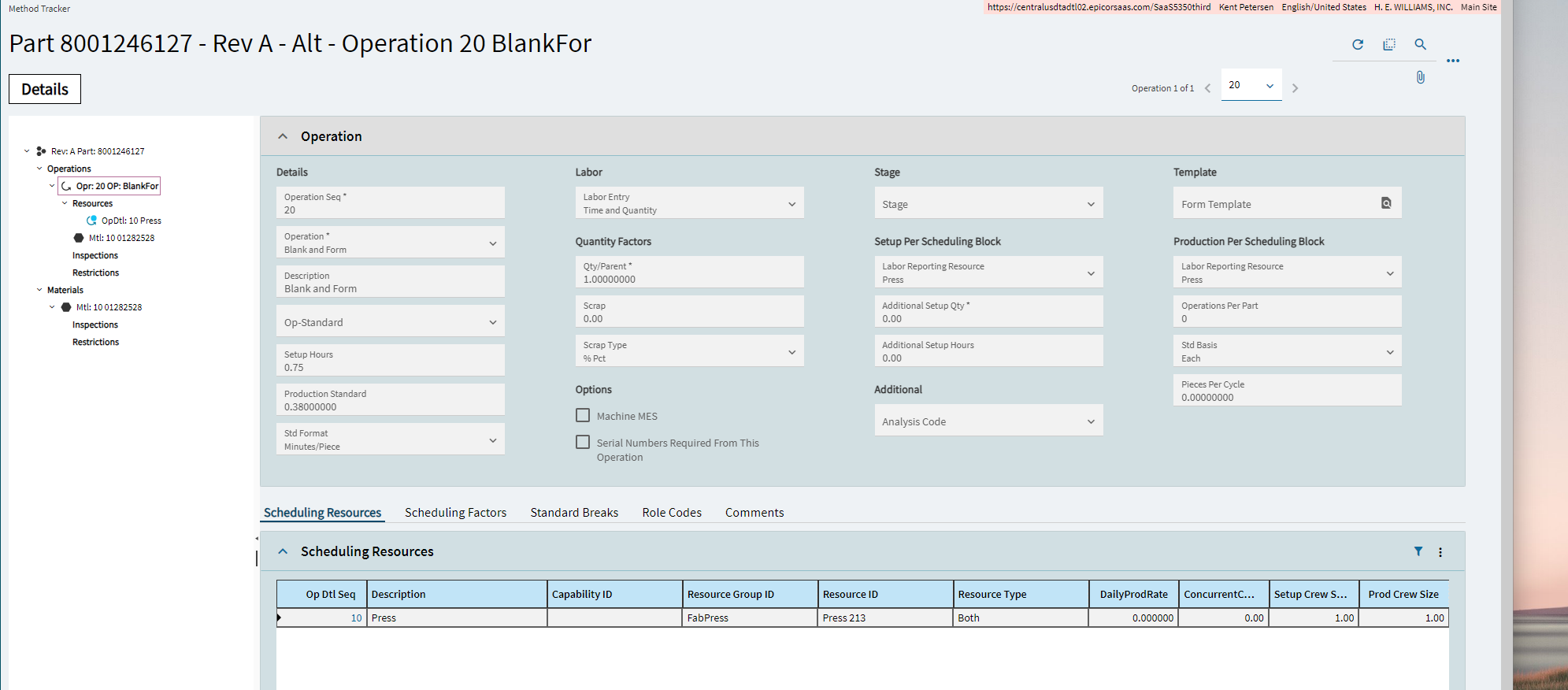

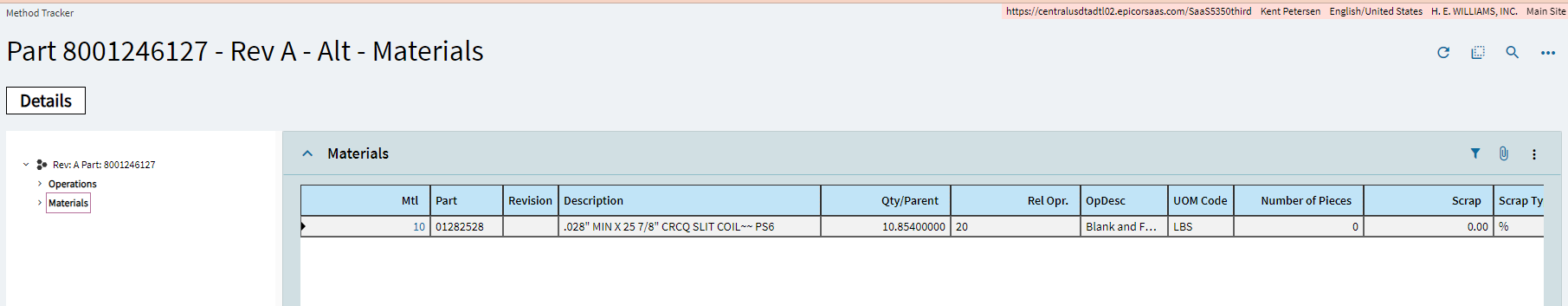

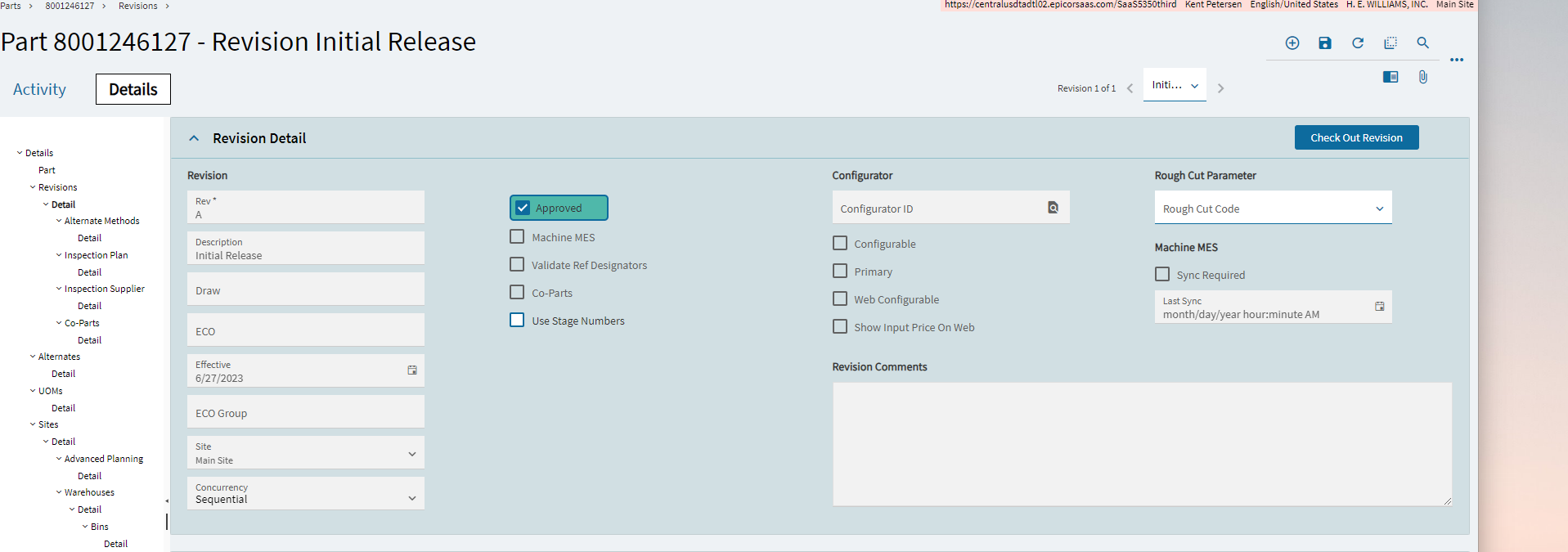

Is the revision approved and does it have Operations and a Quantity for the material?
kpete
(Kent Petersen)
August 21, 2023, 4:00pm
8
Yes, manf part says approved.
it has a blankform operation
material shows 10.854 pounds of steel
