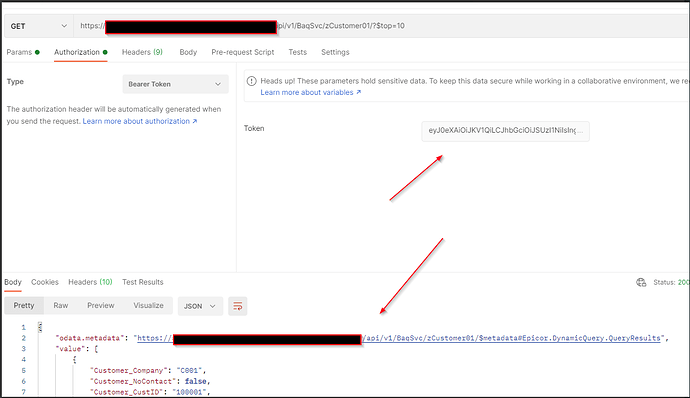

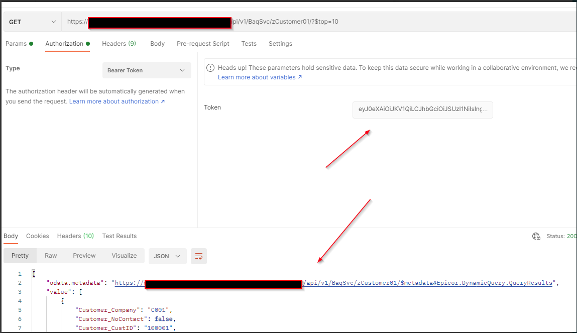

The MSAL Example in GitHub above works out of the box if you plug in your ClientID and your Tenant… but again Epicor Rejects that token if anyone wants to play.
And this version (V1) works out of the box too and well it works with Epicor (that is the token is accepted)
