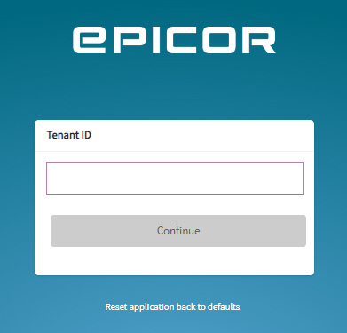

When doing a SSO login, a Kinetic user in a web browser gets prompted for the “Tenant ID” on their first login (we’re on Public Cloud using Azure AD / Entra ID). Someday when they erase their browser cookies they are going to get asked for that again and will not remember what to enter. Is anyone aware of a way to help them with that? For example, if that could be inclued in an argument that I could append to the URL, I could publish that form of the URL.
As far as I know of, no. I just keep reminding them when they ask me.
Thanks, I guess I’ll do that. I plan to tell them to look carefully at the URL, they can see the number embedded in there.
