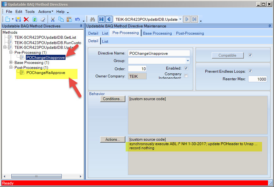

Hi Brandon,
I’m currently working on an updateable dashboard to allow buyers to update release date information without them having to unapprove and get re-approval on a PO. I think you could use same technique with closed jobs.
The unapproval and re-approval (reopen, close again) can get done behind the scenes during the data update. You write it into the “advanced bpm processing” in the updateable query design. You can put Pre-processing and Post-Processing actions to open the job to allow comments to get updated and close the job after update. I’d test to ensure it doesn’t do anything weird and unexpected to financially closed jobs. I would think you could slip comments in there, however.
We’re in 905702, so still using progress code in bpm. If you want to see that let me know.

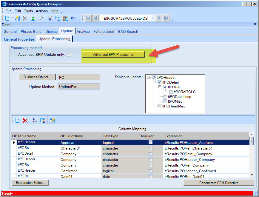

Here’s screenshots of where the little bit of code gets written before (preprocessing) and after (postprocessing) update of records in 905702a, in case you did decide to pursue.
