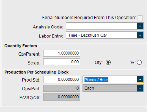

My understanding is that the “Time - Backflush Qty” is the way to accomplish that:
Kevin,
The operation needs to be able to complete the time and quantity, so that’s nothing that I want to update. That labor entry setting is for when you only care about the time and not the quantity produced.
I’m looking to add a material that backflushes at a certain amount per hour, rather than amount per parent. Sure, somebody can revisit the job when complete, look at the hours booked against this operation and issue the material, but I’m trying to automate that.
