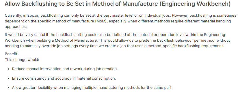

I had a look for an idea but couldn’t find anything so here one is…
https://epicor.ideas.aha.io/ideas/KIN-I-6394
Hopefully that idea is the same thing you guys were after!

Thanks for putting this in, you did a great job capturing everything in your write up. Myself and two others voted for it today; we’re all hoping to see it get some traction!
Thanks! I think it has some good use cases not just for us as but for lots of you guys going off this thread, so fingers crossed this is something that gets added in :folded_hands:
