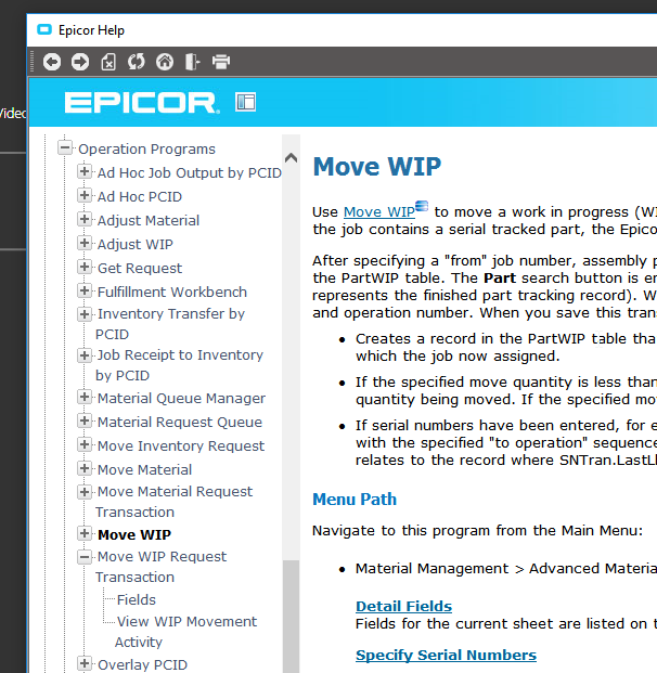

Did you read through this is the help files yet?

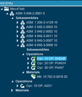

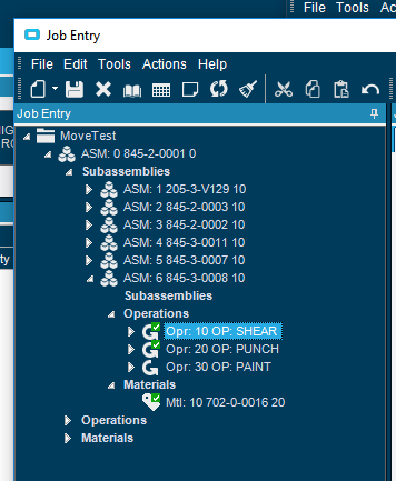

So I’m working on an example for this. Here’s what seeing. (I have auto move on for this test)
Here’s my job structure. I just complete op 10 and op 20.

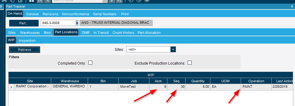

When I look in part tracker for this part to say where it is. It is at “paint” which is OP 30 (I haven’t started that yet). So the parts, when they are done from one op to the next move to the next operation. All of our wip just sits in bin 1, so that’s the bin location set up for auto move in the resource group.

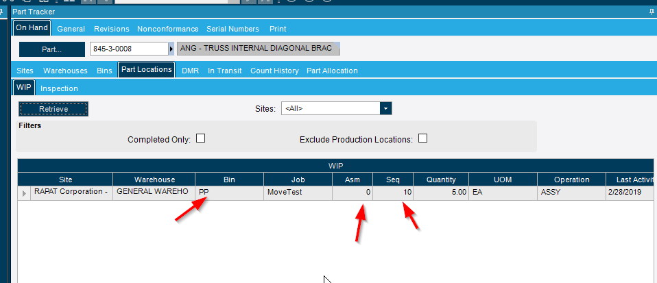

So if I complete the paint operation. The part in now moved to bin PP. (Post Paint) and is at Asm 0 (the top level) operation 10.
So now if I complete operation 10 on the top level part, the assembly goes away. It’s “backflushed”. I didn’t do anything but complete operations.

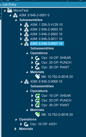

Now here are some gotchas with AMM that make this system sort of useless in the real world.
I didn’t do any of the operations for the other assemblies, as you can see,
So if I go and complete these operations.

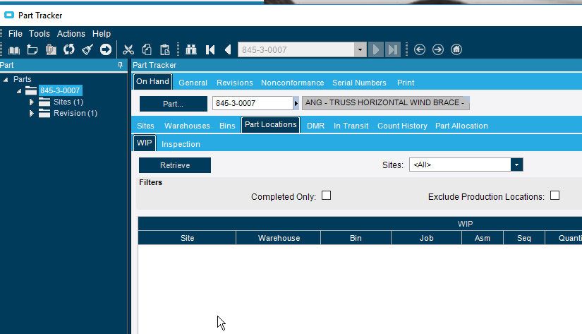

The part never shows up in WIP. This actually surprised me a little bit, as I though without negatives being allowed, I thought it would show up. But it didn’t, so it’s been “backflushed”

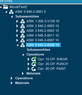

so now with auto-move turned off. I will do the same things. I completed op 10 and 20.
Part tracker now shows the parts at the next operation. I was thinking with auto move turned off, it wouldn’t be that way, but it does. It looks like it’s working the same way with auto move turned off. (Which is interesting
) I’m wondering if I need to do something else here.
