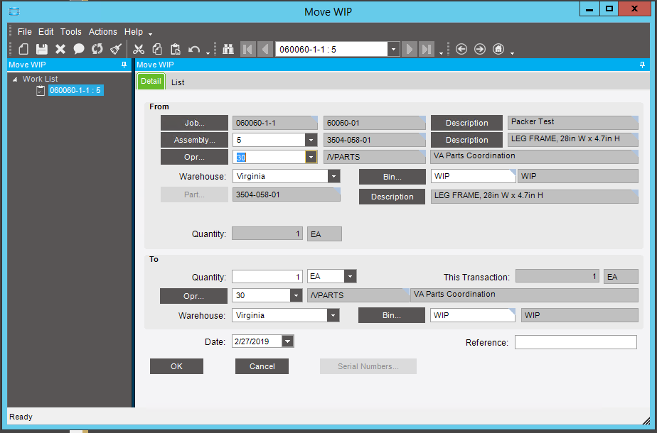

Brandon; we are currently trying to figure out how to use Move WIP to get the completed assembly “issued” to the parent:
What do you suggest? What is the easiest way to achieve this?
Thanks!
You don’t use move wip to issue to the parent. When an operation is done, it automatically moves to the next operation, or creates a move request in your material queue. Make a job with a simple BOM, and follow the parts through the job and you can see it work. Use part tracker to see it flow through.
So for our simple job with an assembly: this contains a subassembly with three operations; upon completion of the third operation how would you get the subassembly to the parent?
It goes there automatically, when you look in part tracker, it will show you the assembly and operation that the part it on. That assembly sequence is not the one that the part is, it’s the parent one.
I can check all of this when I get a chance, but I’m 90% sure that’s the way it works. If it’s not there, then open up your material queue you should have a move request.
I could be wrong, because we have auto move on everything.
