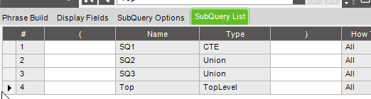

If you can normalize the columns (same number of columns in the same order - use dummy/constant values if you need to for columns that are valid in one query and not the others) then the three can be combined as UNIONs. Keep in mind that UNION will remove duplicate rows while UNION ALL keeps them.
Make SQ1 a CTE, SQ2 a UNION, SQ3 a UNION and then add a TOP LEVEL that just references SQ1. Add in any grouping/summing on the TOP LEVEL query and it will be an aggregate of the combination of SQ1, SQ2, and SQ3.

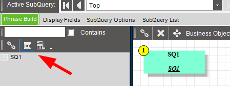

Ok but how do i link them in the phrase builder for the Top? Or what does the Phrase Builder look like for the Top?
Click on the SubQueries icon above the list of tables and SQ1 will automatically be the only option to bring in.
The key here is that the UNIONs combine the results from SQ1, SQ2, and SQ3 and then having SQ1 as a CTE allows the top level query to see the combination as essentially a separate table.
If you haven’t worked with CTEs before, here’s a quick rundown on the basic concepts:
They’re really handy for creating temporary datasets that get used in a query, similar to a temp table if you were working directly in SQL.

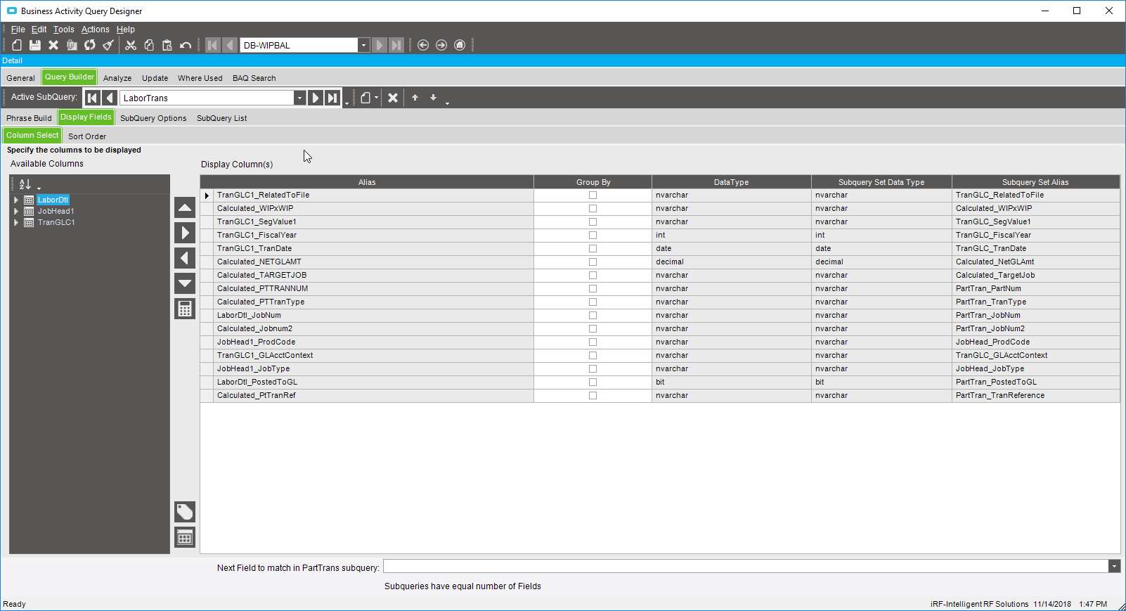

See the Labor Trans setup. I had to create calculated fields to make them match part trans for the Union and I think they are accurate. But perhaps I am wrong.
oK. I figured it out. I had a stupid subquery filter on Labor Trans aka SQL2. I desperately need to hire someone internally for this. As the CFO, CPA, I am not educated for this stuff. Thank you for all your help.
