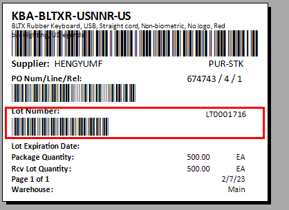

I have a user account that I’m having a reporting issue with…but it’s just this account.
No matter what PO/receipt we pull up, if the part in question is not lot tracked, when tags are printed this same lot number comes up. Parts/receipts that are lot tracked and have lot data print just fine.
@rirish With the print dialog open for that user try action remove defaults. You may also see a Personalization in Personalization Purge for that dialog.
