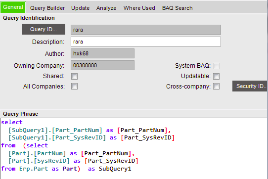

Here is an odd thing in 10.2.300 – If you add any table InvcDtl, Part, Order and add the SysRevID – works fine… then you make that a InnerSubQuery, and make a new TopLevel SubQuery… then it doesn’t like it… only SysRevID… it hates being wrapped in 10.2
When a Table is Wrapped in a Sub-Query the SysRevID Column no longer works. Only in BAQ Designer. Known Bug?

Well, now this bug is known.
It is there for years.
I will report the issue, despite the wondering why you need SysRevID field content in your query output…

It seems to be because 10.2.300 adds “zf.SystemCode = it.TableOwner” to its Query, which those Sys tables fail.

That is known issue. I’m sorry. We fixed it in 10.2.400 but I didn’t receive any official hotfix requests for 10.2.300.
