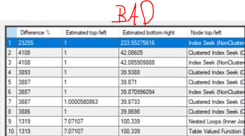

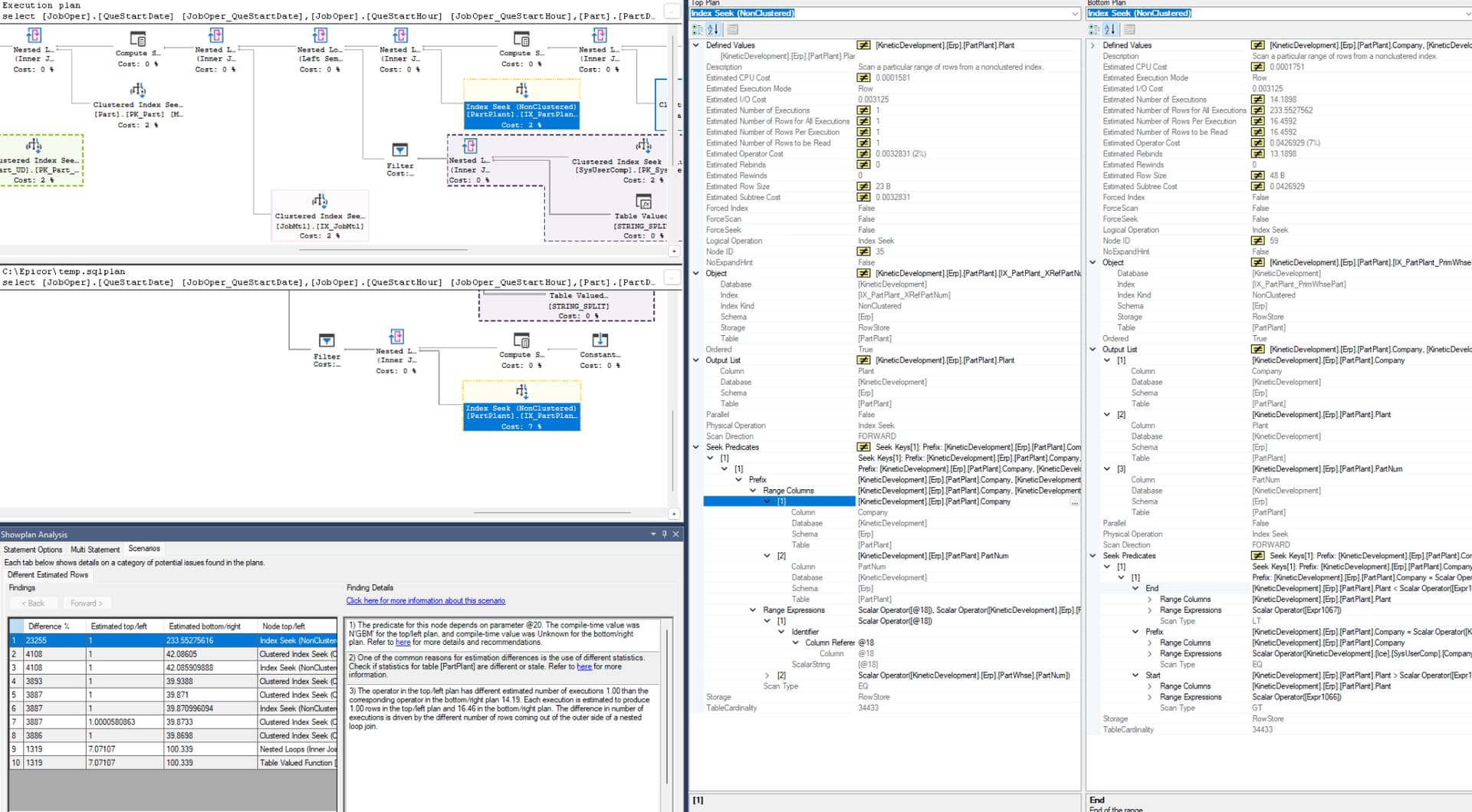

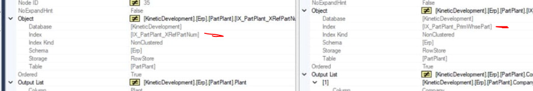

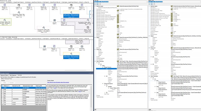

Throw in a Where Clause on the 1st table in the query on Company = @CurrentCompanyID and see if that runs the query, if it does then its a SQL Indexing Issue, which we actually just ran into @jgiese.wci and I, where without it the query would run for 20 minutes our was related to PartPlant table, which didnt make sense but the SQL Plans use totally different Indexes and one is fast, other one is extremely slow due to epicor injecting a CROSS Apply on SysCompany because PartPlant is related to Plant Security.

Left: Added Company to Where Clause
Right: No Company since its not a Cross-Company BAQ
PS: Also the opposite is true, we had a Sub-Query with Company in the Join Relationships being slow, once we removed Company it was fast related to JobHead → JobProd.
