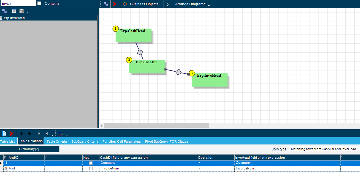

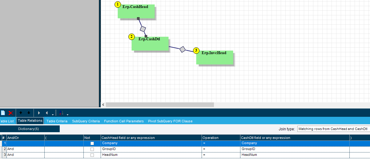

select *
from Erp.CashHead as CashHead
inner join Erp.CashDtl as CashDtl on
CashHead.Company = CashDtl.Company
and CashHead.GroupID = CashDtl.GroupID
and CashHead.HeadNum = CashDtl.HeadNum
inner join Erp.InvcHead as InvcHead on
CashDtl.Company = InvcHead.Company
and CashDtl.InvoiceNum = InvcHead.InvoiceNum
