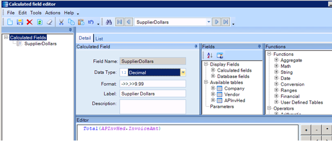

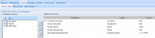

OK, so because the invoice header table is in summary mode you cannot display any invoice header fields directly.
On the BAQ display tab use the calculated field button to start a new calculated field and title it InvSum or similar. Set it as a decimal field and give it a label.
Then go to the aggregate function and find the Total(). Then add the invoice amount field in the parentheses.
My example below is a vendor ranking, but very similar.

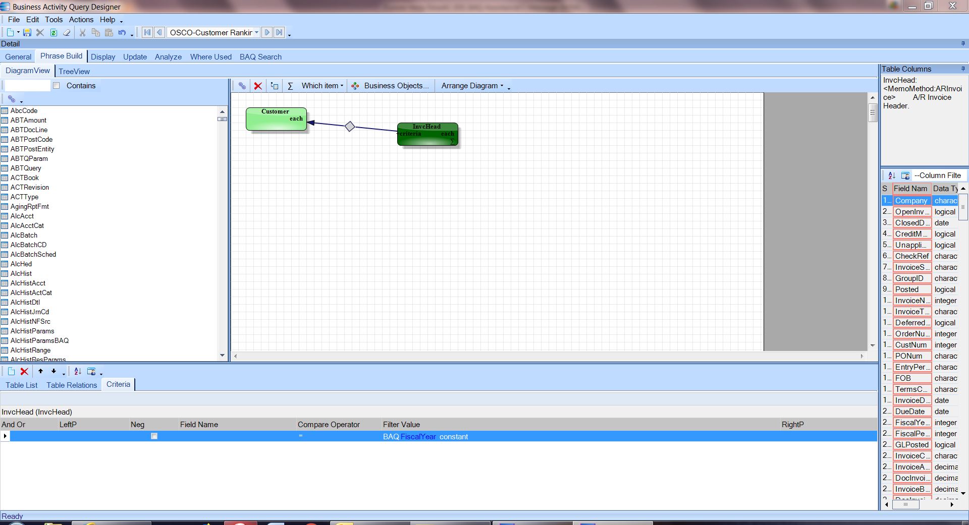

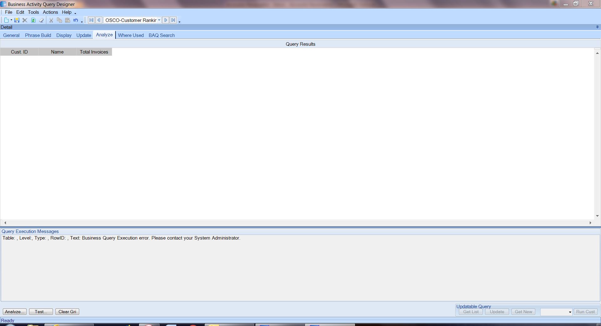

Hey Brad,
I’m just now getting back to working on this BAQ due to the holiday schedule. I followed your instructions, and this is the error I get. Any suggestions?

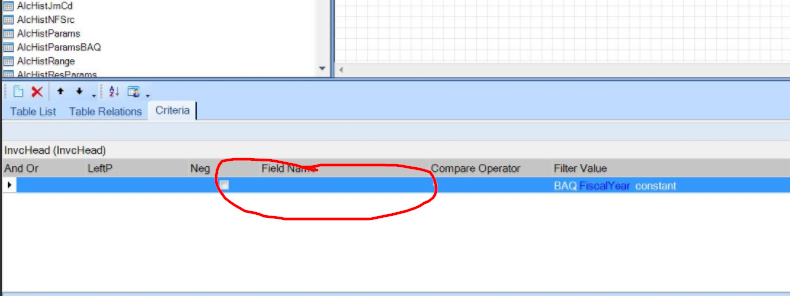

Can you post a screen shot of your invoice header criteria?
And your calculated field?
It looks like one of those two.

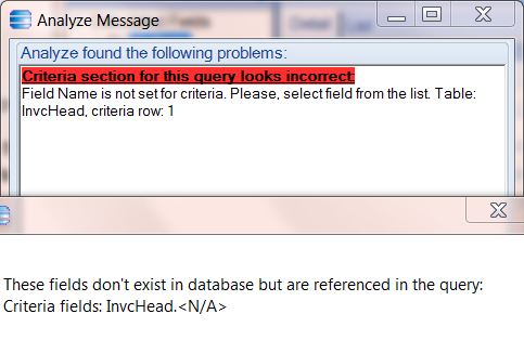

Good afternoon, gentlemen. I am just now getting back to this project again and am still having problems. It seems you are both coming at it with a little different approach. Per Calvin’s suggestion, I added the field name “InvoiceDate” and then got an error message stating I couldn’t display the invoice date or invoice number because InvcHead is a summary table. So I removed those two items from the display and now get this message.
What does your invoice header table criteria look like now?
