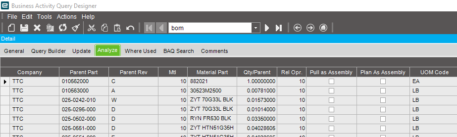

I attached the fields i pulled in for the BAQ. Here is the test screen. If you look at the first # 010562000 we use the 882021 plus another material. I need both to show up on this BAQ
Does that help at all?
Sorry here is the attachment
If it is just PartMtl then there a condition stopping the rest. Are there other tables that are joined but not displayed? I would start with no conditions.

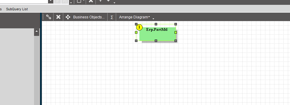

i only have the Part Mtl on it
@knash I think she is just dumping PartMtl, so all materials should show.
Yes but this will not be a multi-level BOM.
sorry it is working. I see what i did wrong. Thank you everyone
