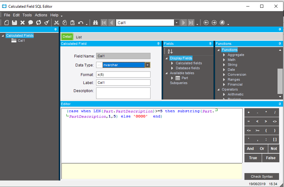

case
when CheckHed.EntryPerson=‘dmtuser’ and len(APTran.Description) > 10 then convert(date, substring(APTran.Description, len(APTran.Description)-9 ,10 ), 101)
else CheckHed.CheckDate
end

2 - If I had to guess, then I would say that the substring result is not always convertible to a date
otherwise the rest of the query looks good. For a test, just remove that calculated field.

if you want to use this convert string to date function your string should comes on xx/xx/xxxx format all the time, if you only need the result to be read then remove the conversion statement.
