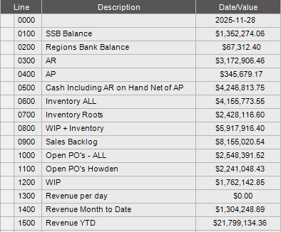

This was close enough, it centered it for some reason.
case when UD14.Character01 = ‘’ then ’ ’ + UD14.Key2 else substring(’ ',1,20 - len(FORMAT(UD14.Number01, ‘C’, ‘en-us’))) + FORMAT(UD14.Number01, ‘C’, ‘en-us’) end

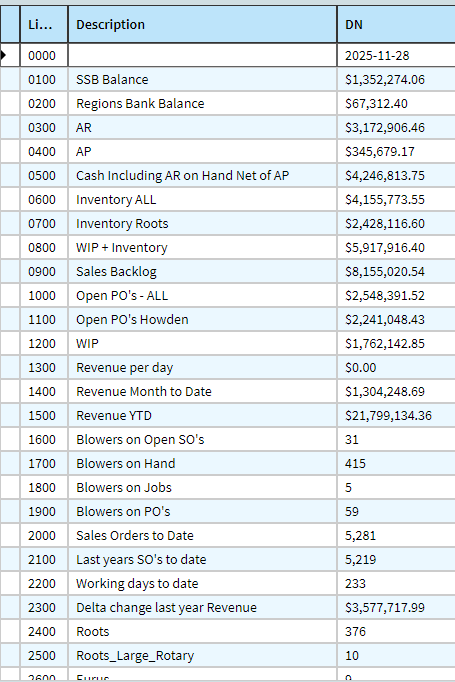

Now when I put it into a dashboard, the Classic version display my newly centerd numbers but the Kinetic version left justifies the numbers again. WTF!!!

If you look at my screen shot, you can see that the first row has a date in it as a column heading. I need to convert everything to a string in order to have date and currency values in the column. Is there a better way to do this?
Thanks,
Richard
Someone either applied or didn’t disable a trim() affecting everything in these grids.
Of all the whitespace characters (Wikipedia has a list), the one that canned trim() functions should never trim is the Braille space.
Copy/paste one of those. If that gets trimmed, that’s a bug that might actually compel a presentation fix. The UI should never fool around with Braille for appearance reasons.
in your formula above try replacing ' ' with CHAR(160)
Thank you so much Kevin.
The CHAR(160) worked great!
