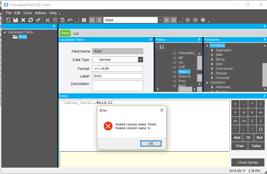

I am trying to use a column in calculated field the has a special character in it’s name. I tried enclosing the name in square brackets, but that didn’t work. Any ideas?
External BAQ Editor? I think that’s not valid SQL so it’s splitting the field into two fields.

No, not External BAQ Editor. The query works in SQL Server Mgmt Studio, but not in BAQ Designer. I am doing a PIVOT on the OpCode, two codes have the dash. I can add the pivot fields through display columns and Epicor wraps them in square brackets, but I can’t get it working in Calculated Field Editor.

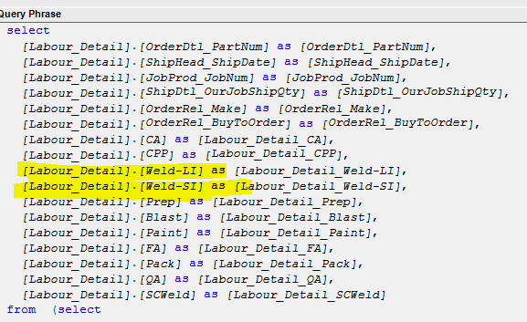

how does the query phrase look on the general tab when you add those fields through the display columns?
