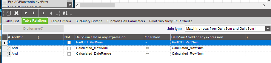

Can you make the Max(pt.trannum) a subquery, then in the joins, you can just change = to < (you have to type it in. There isn’t any drop down)
Here’s a part of a query that I need more than a 1:1 join. I was able to use two joins with < and >
where (PartDtl1.RequirementFlag = 1)
group by [PartDtl1].[Company],
	[PartDtl1].[PartNum],
	[PartDtl1].[DueDate],
	[DateTable].[Calculated_DateRange],
	[DateTable].[Calculated_RowNum],
	[Part1].[DaysSupply_c])  as DailySum1 on
	DailySum.PartDtl1_PartNum = DailySum1.PartDtl1_PartNum
	and DailySum.Calculated_RowNum <= DailySum1.Calculated_RowNum
	and DailySum.Calculated_DateRange >= DailySum1.Calculated_RowNum
inner join Erp.Part as Part on
	DailySum.PartDtl1_Company = Part.Company
	and DailySum.PartDtl1_PartNum = Part.PartNum
	and ( Part.TypeCode = 'P'  and Part.UsageExclude_c = 0  )
